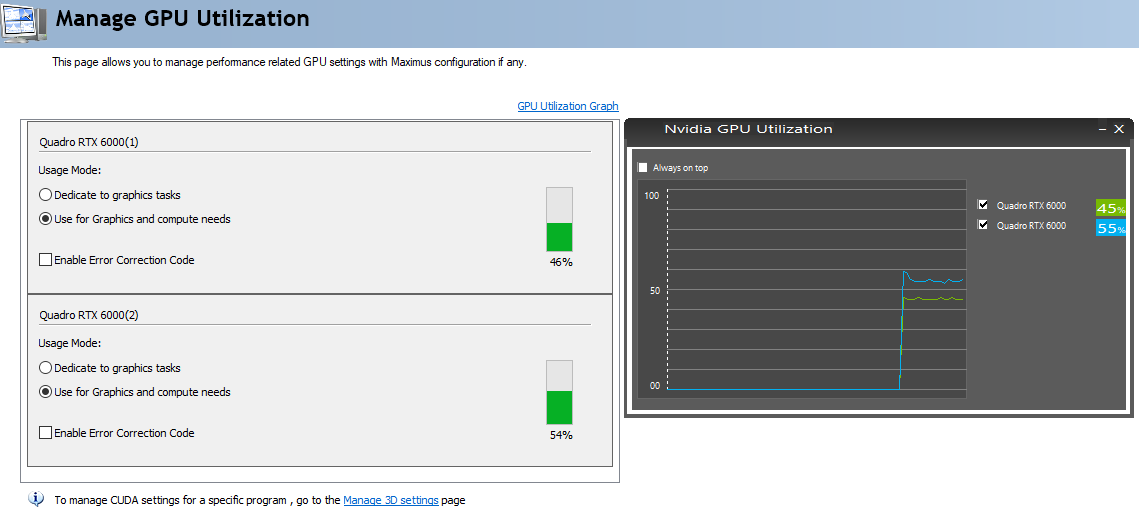

  • To make sure the multi GPU integration is correctly splitting both Engines to each GPU, the NVIDIA GPU Utilization utility on the NVIDIA Control Panel can be used;
