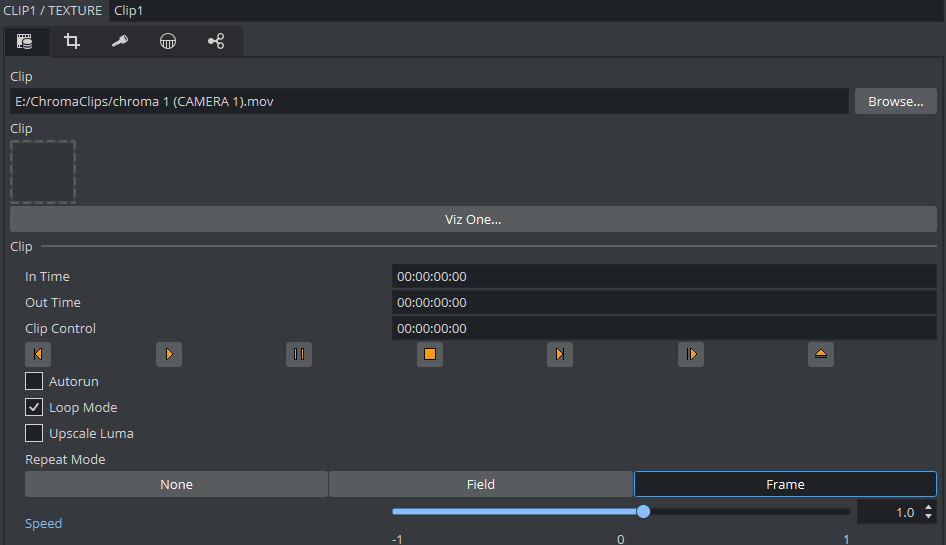

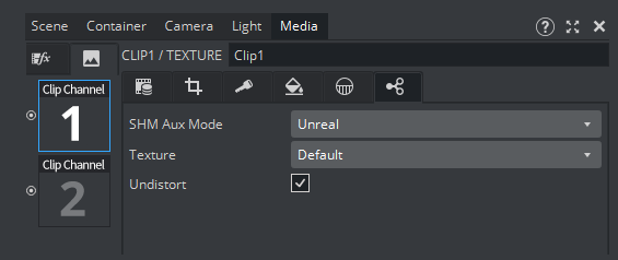

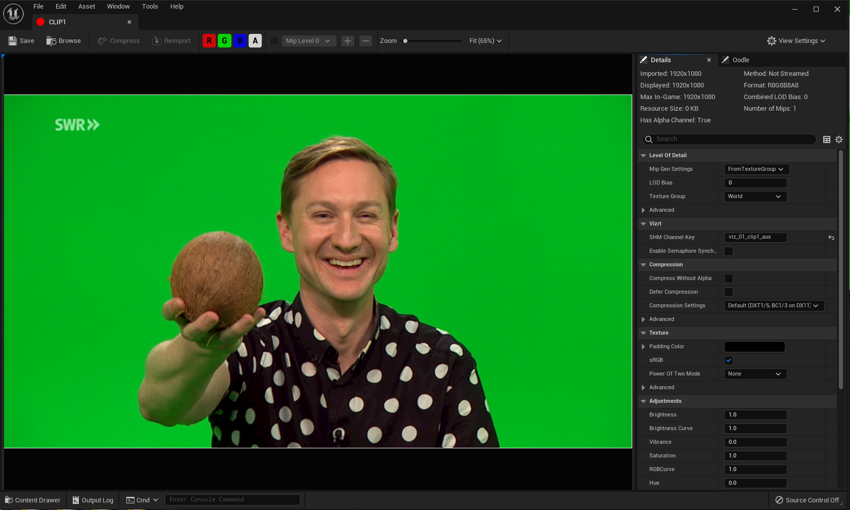

To send the Clip scene in Viz Engine and have it playing in Unreal:
  • Grab CLIP1 from the plug-ins.
  • Add to the Media tab.
  • Add a clip.
  • Make sure you are sending the Original clip if you want to change parameters with Viz Arc
  • In the Unreal Engine, find the CLIP1 asset. It receives the clip when in play.

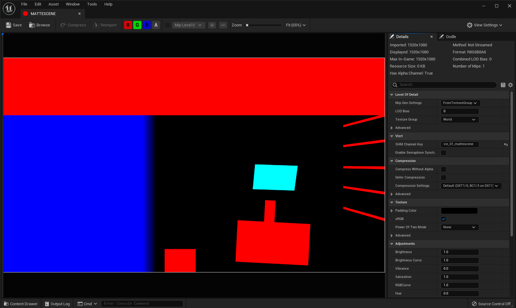

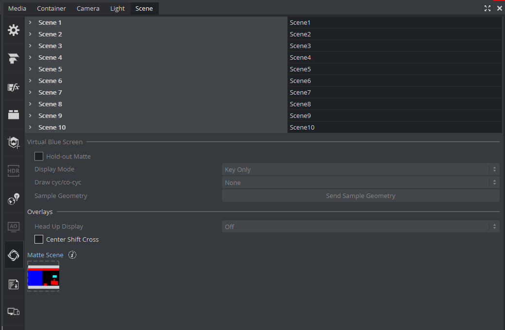

To send the Clip scene in Viz Engine and receive it in Unreal:
  • Add a Matte Scene in Viz.
  • In the Unreal Engine find the MATTESCENE asset, it has the matte scene when in play.

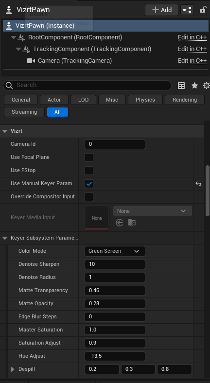

The UE Precision Keyer can now be synced with Viz Engine and Viz Arc. As soon as the parameters change on Viz Arc, they are synced with Unreal Engine. Some small tweaking can be done via Viz Arc.

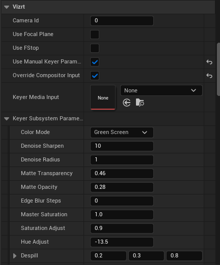

If for some reason we want to have Unreal overriding the parameters that come from Viz, the Keyer settings are now on a separated tab in the VizrtPawn object. To do so we need to tick Use Manual Keyer Parameters.
If we want to override the Compositor media input (or if we do not have a Compositor in the level) we need to tick Override Compositor Input.

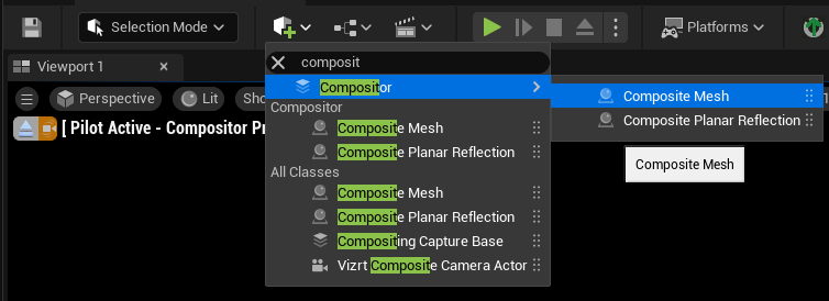

Setting up the Composite Mesh

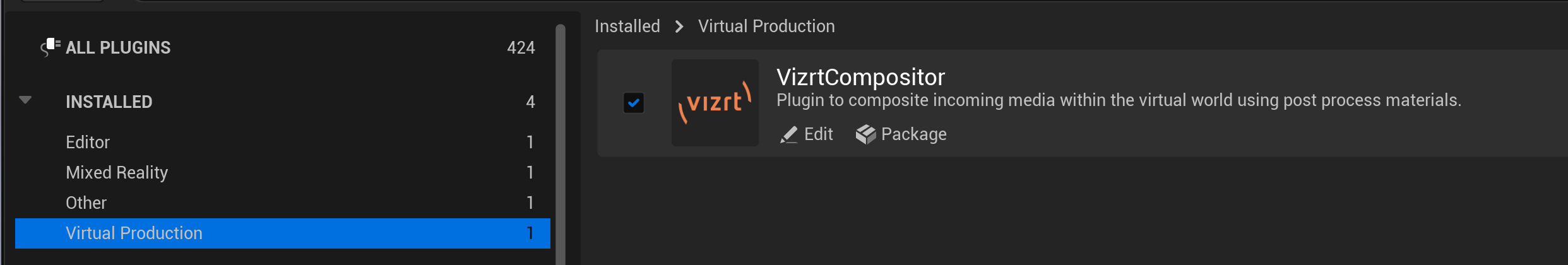

If the plug-in is not activated by default we need to activate it.
We need to drop the Composite Mesh into the level.
After dropping the Composite Mesh into the level we have the following:

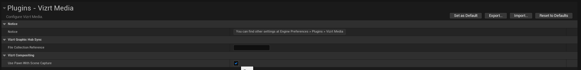

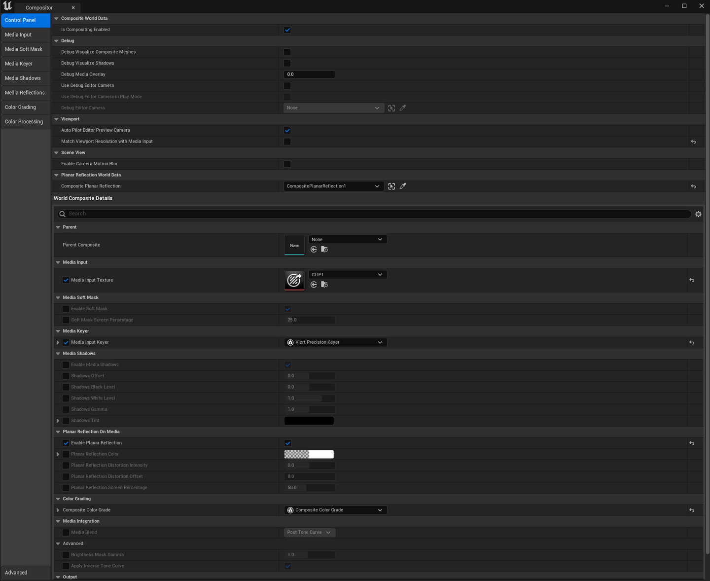

Make sure you have the following activated on your Project Settings.

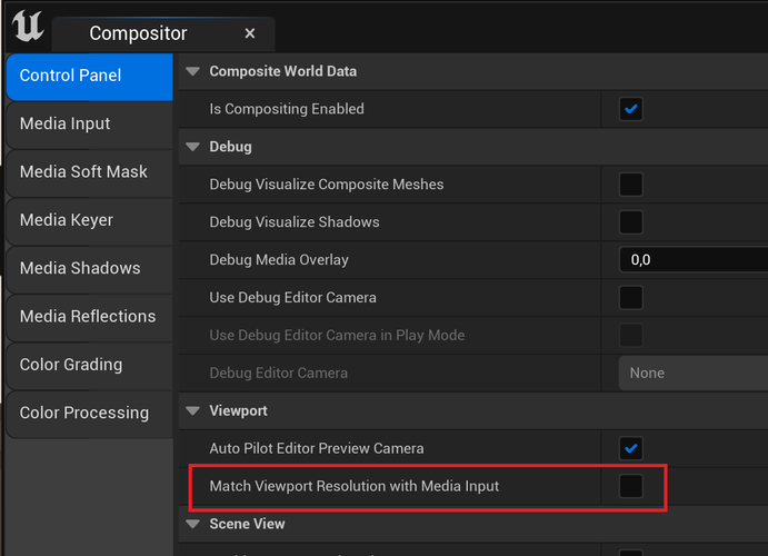

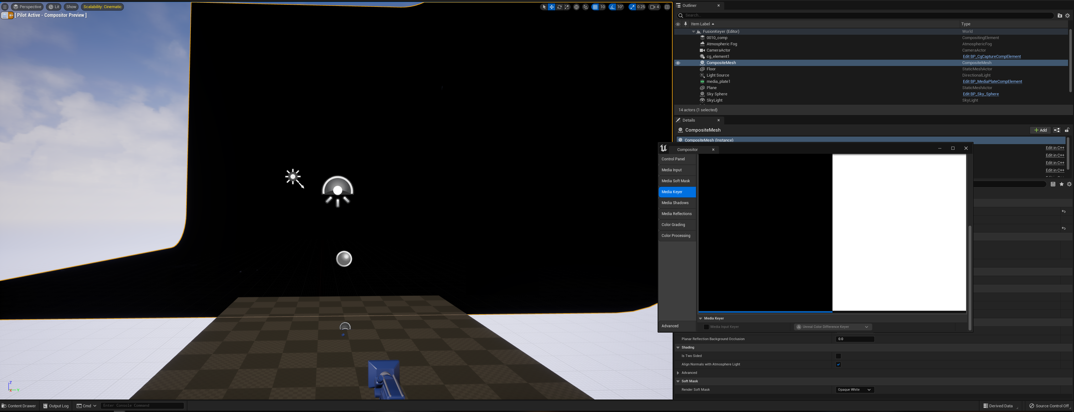

To change Compositor settings we need to open the Compositor Menu.
That shows the following menu.

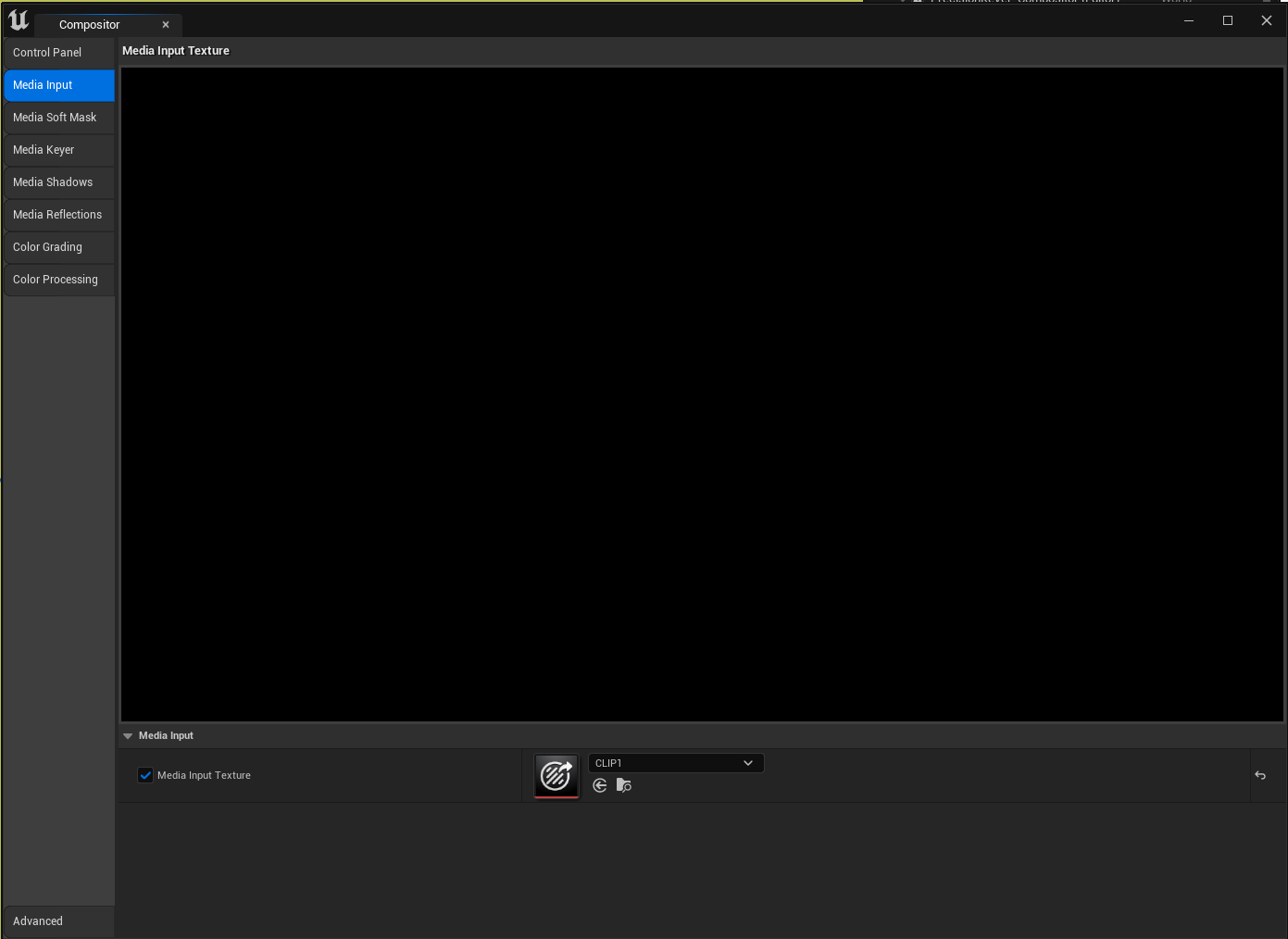

In the media input tab, select the input to use for the compositor.

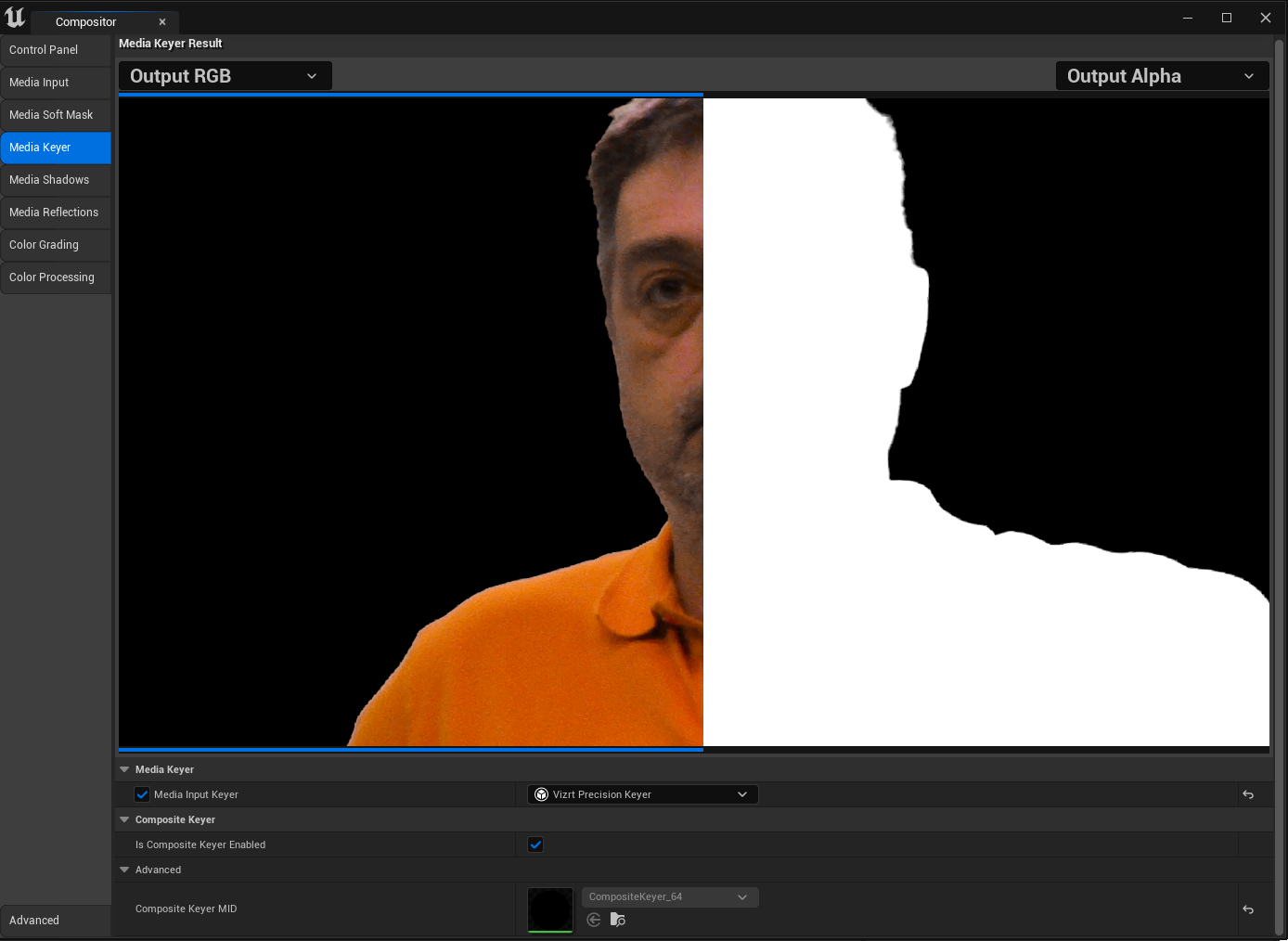

To setup the Keyer go to the Media Keyer tab and select the Vizrt Precision Keyer
Note: If the Unreal output is being sent to Viz Engine through an AUX asset with the Overscan option set to True (used when Lens Distortion is active), the option Match Viewport Resolution with Media Input must be set to False.

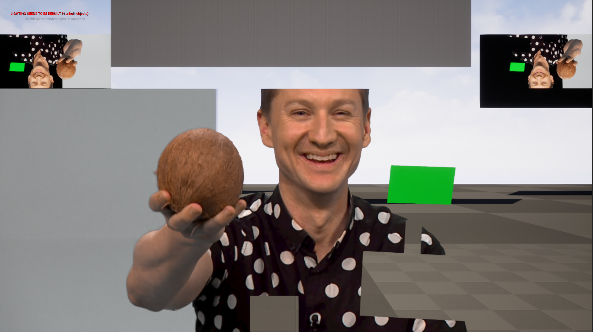

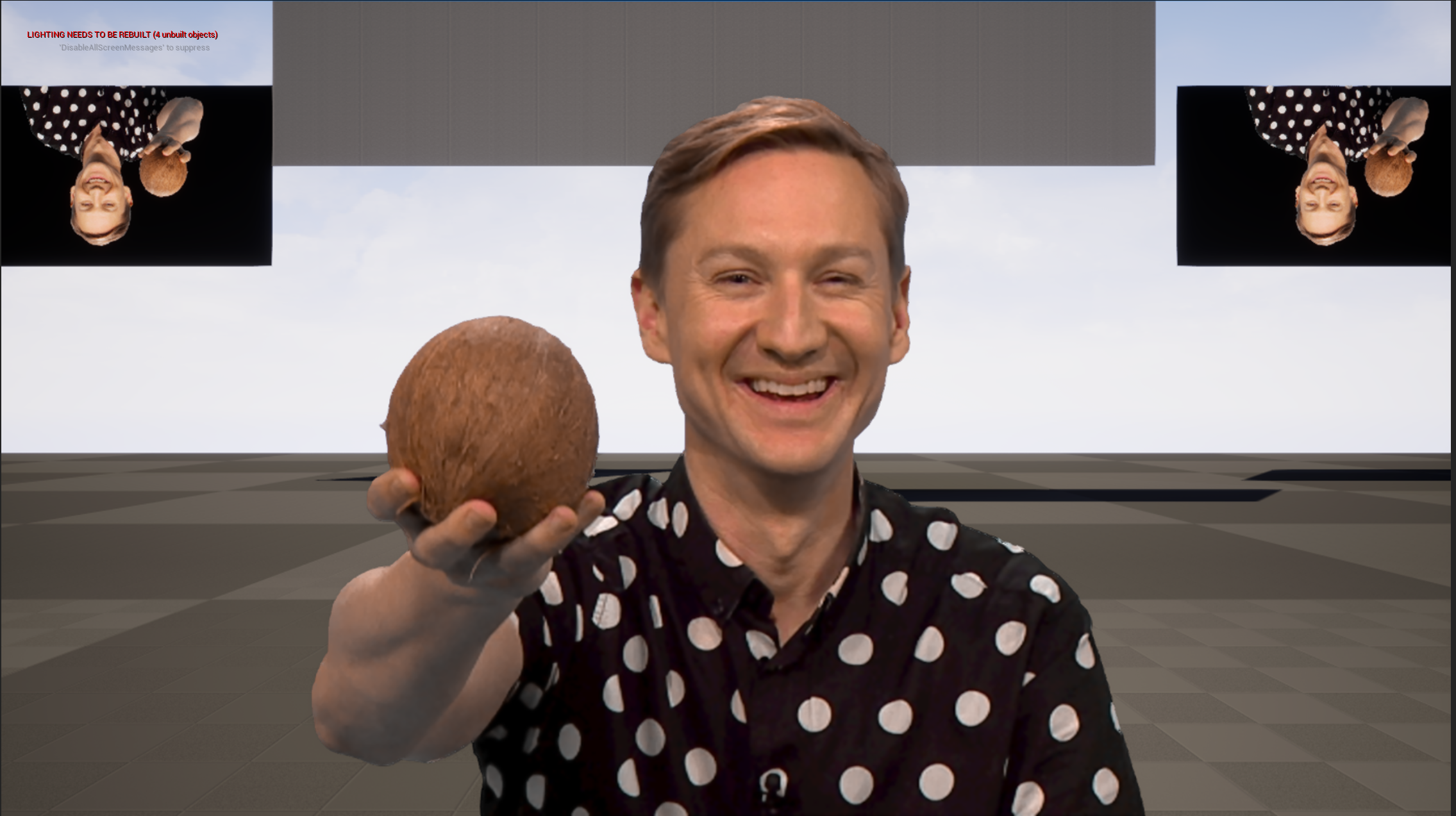

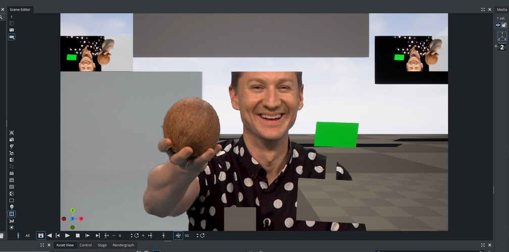

This is the result from the Precision Keyer:
If we have a matte scene the result reflects that.
This also shows on the Viz Engine side if the AutoCapture is properly set up.

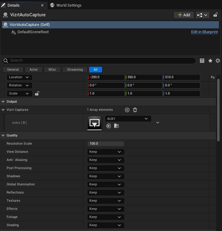

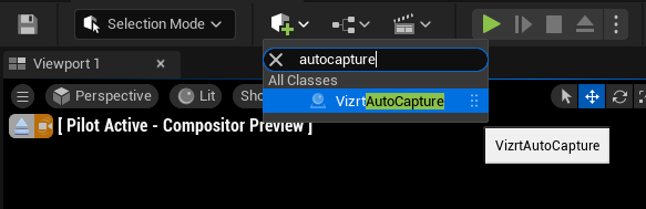

Setting up the AutoCapture to Share the Result with Viz Engine
Drag the VizrtAutoCapture into the level.
Make sure it has AUX1.
When playing the level (PIE or Game Mode), the output is shared with Viz Engine.
