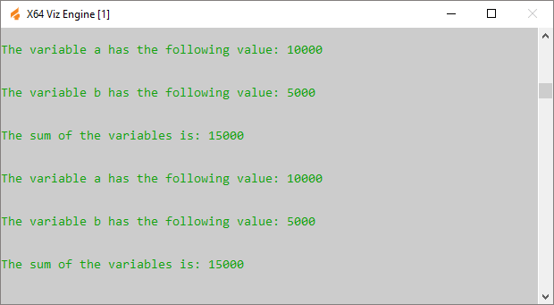

Initializing Scripts
This example declares and defines two variables with a value. In the main procedure OnInit() those two variables and their addition are output to the console using Println.
Callback procedures like OnInit() are used to initialize scripts.
'Declaration of the variables
dim a as Integer
a = 10000
dim b as Integer
b = 5000
'Start of the main procedure sub OnInit()
'Executing the commands
println "\n"
println "The variable a has the following value: " & a
println "\n"
println "The variable b has the following value: " & b
println "\n"
println "The sum of the variables is: " & a + b
'End of the main procedure
end sub
Result output to the Viz Engine console:

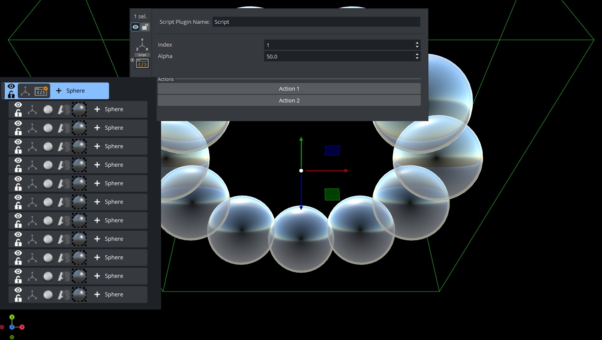

Register Parameters
This script example creates a custom editor for filling in index and alpha values. The index value decides which container does not receive the alpha value, whereas the alpha value is set for all other containers.
sub OnInitParameters()
RegisterParameterInt("index", "Index", 1, 1, 7)
RegisterParameterDouble("alpha", "Alpha", 50.0, 0.0, 100.0)
RegisterSpacer("space", 30)
RegisterSeparator("sep", "Actions")
RegisterPushButton("action1", "Action 1", 1)
RegisterPushButton("action2", "Action 2", 1)
end sub
sub OnExecAction(buttonId as Integer)
dim c as Container
dim i, index as Integer
dim a as Double
index = GetParameterInt("index")
a = GetParameterDouble("alpha")
i = 1
c = ChildContainer
do while c <> null
    if i = index then
        c.alpha.value = 100.0
    else
        c.alpha.value = a
    end if
i = i + 1
c = c.NextContainer
loop
end sub

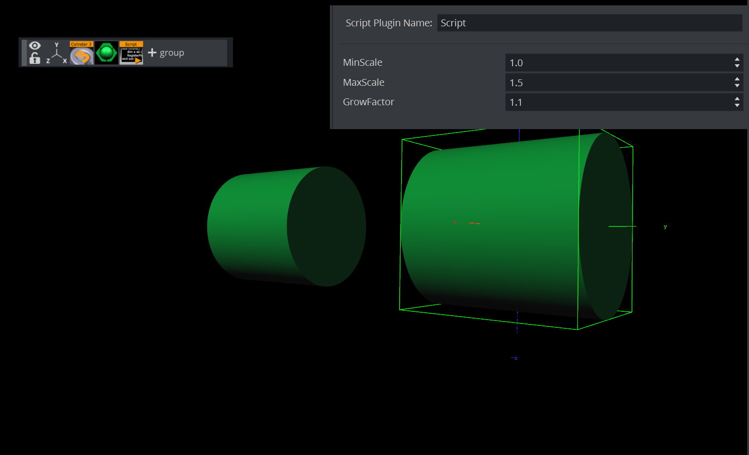

Mouse Events III (Grow and Shrink)
With this script added to a Container an object grows when the mouse is hovering over the object and conversely. In this case, the center of the object is set to the lower right corner to let it grow out from that center.
dim growing as Boolean = false
RegisterParameterDouble("min", "MinScale", 1.0, 0.0, 10.0)
RegisterParameterDouble("max", "MaxScale", 1.5, 0.0, 10.0)
RegisterParameterDouble("fac", "GrowFactor", 1.1, 1.0, 10.0)
end sub
sub OnEnter()
growing = true
end sub
sub OnLeave()
growing = false
end sub
sub OnExecPerField()
dim min = GetParameterDouble("min")
dim max = GetParameterDouble("max")
dim fac = GetParameterDouble("fac")
if growing then
scaling.xyz *= fac
if scaling.x > max then scaling.xyz = max
else
scaling.xyz /= fac
if scaling.x < min then scaling.xyz = min
end if
end sub
