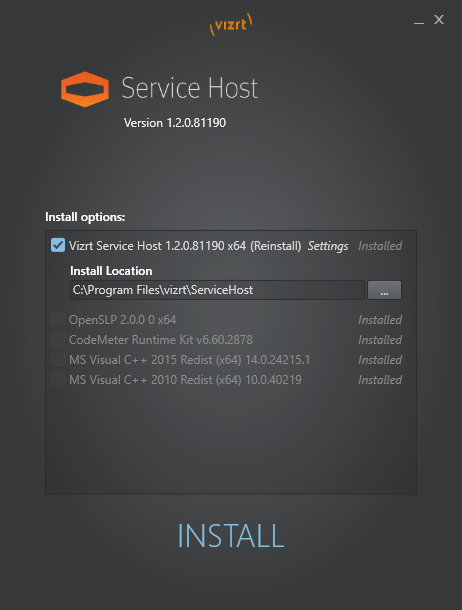

The Service Host installer comes in two flavors:
  • ServiceHostBundle-x64*.exe
  • ServiceHost-x64*.msi
The main difference is that the bundle installer takes care of upgrading an existing installation and installs the required operating system run-times (if not already present), whereas the .msi installer only installs Service Host.
Installation
The bundle installer itself is using the .msi installer. The .msi and other files can be extracted from the bundle. This is mostly used for silent and unattended installs. Please run the bundle with -h command line switch to get all the available options.

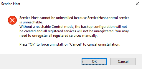

If the Control Mode is unreachable during uninstallation, it is still possible to uninstall. The dialog informs users that the Control Mode is unreachable and prompt users to decide to force uninstall, or cancel. If users force uninstall, users have to manually unregister all Service Host services registered as Windows services.
