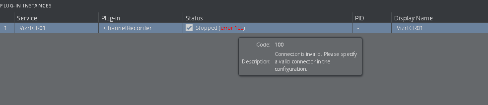

The following errors can occur during initialization. For more information regarding the error it is always good to check the log. The ID associated with the error is displayed in the web interface when starting the instance failed.
Configuration
  • 100: Connector is invalid. Please specify a valid connector in the configuration.
  • 101: Path for clip is invalid. Please specify a valid path in the configuration.
  • 102: Failed to load configuration. Please check that the configuration file exists and is not corrupted.
