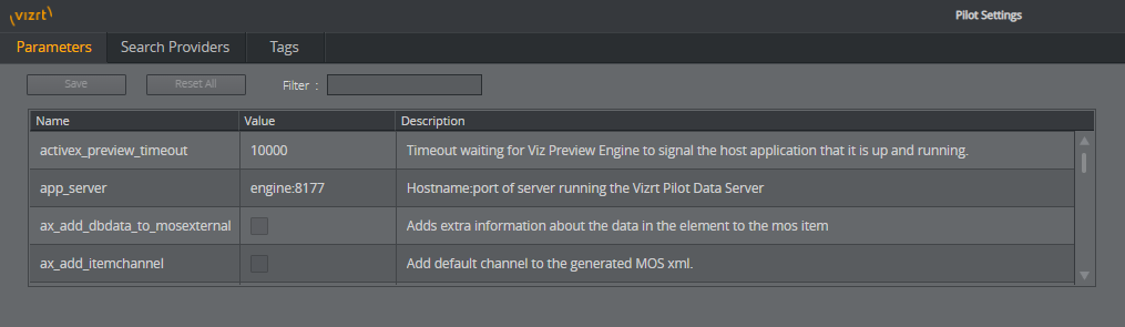

The Settings tab is used to configure the following values:
Database Parameters
Configure Viz Pilot system application settings in the VCP Parameters tab. A description of useful database parameters is listed here.
Granting Applications Access to Pilot Data Server
  1. See how to access the Pilot Data Server Web Interface.
  2. Click the Settings link.
  3. Select the app_server setting and add the parameter for the machine you installed Pilot Data Server on (for example, <DataServer>:8177).
  4. Click Save.
This grants all applications with a connection to the database access to Pilot Data Server.
IMPORTANT! Firewalls must allow inbound communications on port 8177.

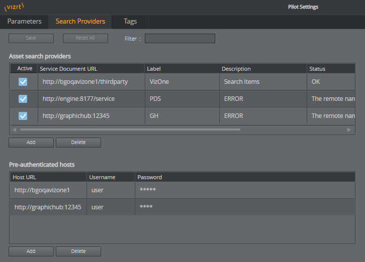

Search Providers
Both Director and Viz Pilot News get their Viz One connection parameters from the Viz Pilot database. Media Sequencer must be configured using your control application. Asset search providers can be set to active or inactive. Disabling a search provider means that it is not used when searching for assets in a template.
Configuring Search Providers (Viz One)
  3. Click the Search Providers link.
  4. Under Asset search providers click the Add button and enter the host’s service document URL: /war
    • For Viz One 5.4 and later: https://<viz_one>/thirdparty/.
    • For Viz One 5.3: https://<viz_one>/api/.
      Make sure to enter the correct protocol (for example, a Viz One set up on HTTPS requires an HTTPS URL).
  5. Add a Short name such as VizOne to help identify the asset’s location, for example in search results.
Note: If you change the short name, you need to restart the server for the changes to take effect (see To modify the Pilot Data Server database settings).
The screenshot below shows the Search Provider Short Name as displayed in search results:
  1. Under Pre-authenticated hosts click the Add button and enter the host’s URL, username and password in order to authenticate your search:
    • URL of the host, for example: https://<viz_one>/.
    • Username and password of the pre-configured user on the Viz One system (configured in the Studio admin web interface).
    • This is required for Viz One (not Object Store).
      WARNING! The username and password used here are available in clear text to anyone who has access to the Settings page. The Viz One user entered here should therefore be given as few rights on the Viz One as possible.
  2. Click Save.
Note: That Crop Server also needs a restart after configuring pre-authenticated hosts, as Crop Server uses the settings from Pilot Data Server.
Configuring Search Providers (RestVOS)
By default, Viz Pilot 6.0 and later uses the RestVOS search, and a search provider representing the current Pilot Data Server is configured automatically. This requires that the correct value (a public name that points to the current Pilot Data Server) has been stored in the app_server parameter in the database parameters. Changes to this value are picked up during restarts.
The auto-added search provider can be renamed or made active/inactive on the Search Providers page. The URI cannot be changed.
Note: Upgrading from Viz Pilot 5.7 to Viz Pilot 6.0 can result in two search providers with the same URL (both the existing and the new provider). Although the new provider is disabled and therefore does not cause an issue, you can delete the old and activate the new provider if you wish to clean up the list.
Note: If you change the short name you need to restart the server for the changes to take effect.

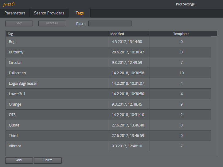

Tags Settings
The Tags Settings page is used for administering tags. The tags are assigned to templates in Template Wizard, and then used in the newsroom component to organize templates.
Accessing Tags Settings
  3. Click the Tags tab.
Tags Settings Functions
Function
Description
Add tag
Click the Add button and enter a name in the Add a New Tag dialog.
Rename tag
Click a name in the Tag list. Enter a new name and click Save.
Reset changes
Click Reset All to reset changes.
Delete
Click Delete to delete a selected tag.
Note: Deleting a tag does not delete the templates that refer to that tag.
Filter
Type to filter on tag name.
