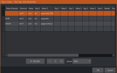

  2. The net shortcut entry in TriCaster Plus macros can be used to send commands over a specific NDI input. The workflow is:
    1. A Viz Engine (either Program or Viz Trio Preview) is set up to output NDI.
    2. In TriCaster Plus, the NDI output from the Viz Engine is assigned as one of the inputs.
    3. The Macro system in TriCaster Plus can be used to send commands via the NDI streams of the inputs.
  3. As an example, if the NDI output from the Viz Engine is on input number #11 in TriCaster Plus, the shortcut entry net11 can be used to address this NDI stream.
    1. Value: vizrt
    2. Key: trio
  4. The value of the key is the command to send to Viz Trio.

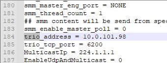

Viz Engine configuration
  • If the Viz Engine receiving the macro commands is the Viz Trio local Preview engine, no configuration is needed.
  • If another Viz Engine (for example, on Program) is receiving the macro commands from TriCaster Plus and these commands are sent to a Viz Trio client on another host, the configuration on this Viz Engine must specify the host address of the Viz Trio client:
    The relevant config settings in the *cfg config file for the Viz Engine are:
    • trio_address = 127.0.0.1
    • trio_tcp_port = 6200
