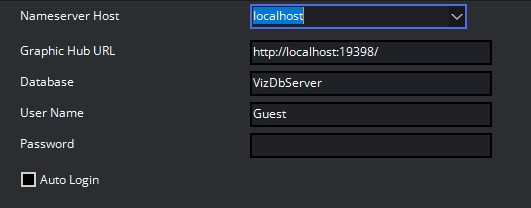

To view the Graphic Hub configuration settings, click Graphic Hub in the Viz Trio Configuration.
Graphic Hub Configuration Settings
These are the configuration settings to log on to Graphic Hub. All settings are local to the specific Viz Trio client.
Nameserver Host: Sets the hostname or IP address for the Viz DB server.
Graphic Hub URL: Sets the URL of the Graphic Hub REST service. If configured and running, Viz Trio uses GH REST to fetch the thumbnails for the page and playlists.
Database: Sets the name of the Graphic Hub database.
User Name: Sets the user name used for logging on to the database.
Password: Sets the password used for logging on to the database.
Auto Login: Enables Viz Trio to log on automatically at startup.
Note: If the local Viz Engine’s Auto Login is enabled, this option is disabled.

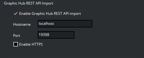

Graphic Hub REST API Import
These are the configuration settings to enable and configure scene import using Graphic Hub REST API.
Enable Graphic Hub REST API Import: Enables default usage of Graphic Hub REST API Import when importing scenes. Will fallback to normal import if not possible to import with REST API.
Hostname: Sets the Hostname of the Graphic Hub REST API service.
Port: Sets the Port of the Graphic Hub REST API service.
Enable HTTPS: Enables usage of HTTPS protocol in Graphic Hub REST API Import.
