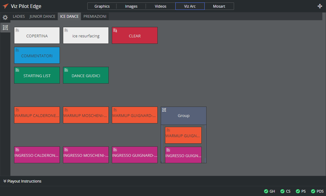

Viz Arc can be integrated with Viz Pilot Edge. In this workflow, Viz Arc actions can be browsed, selected, dragged to the newsroom rundown and played out by a control client such as Viz Mosart.

To display the Viz Arc panel in Viz Pilot Edge, add the following settings in PDS (see the Pilot Data Server documentation on how to add Optional Database Parameters):
Parameter | Mandatory | Default Value if not set | Description |
moseditor_arc_url | yes | The URL to the panel. | |
moseditor_arc_schema | no | http://www.vizrt.com/mosObj/vizarc/action | A unique identifier for the editor to be able to reopen Viz Arc actions from the rundown. |
moseditor_arc_label | no | Viz Arc | Label appearing on the tab in Viz Pilot Edge. |
