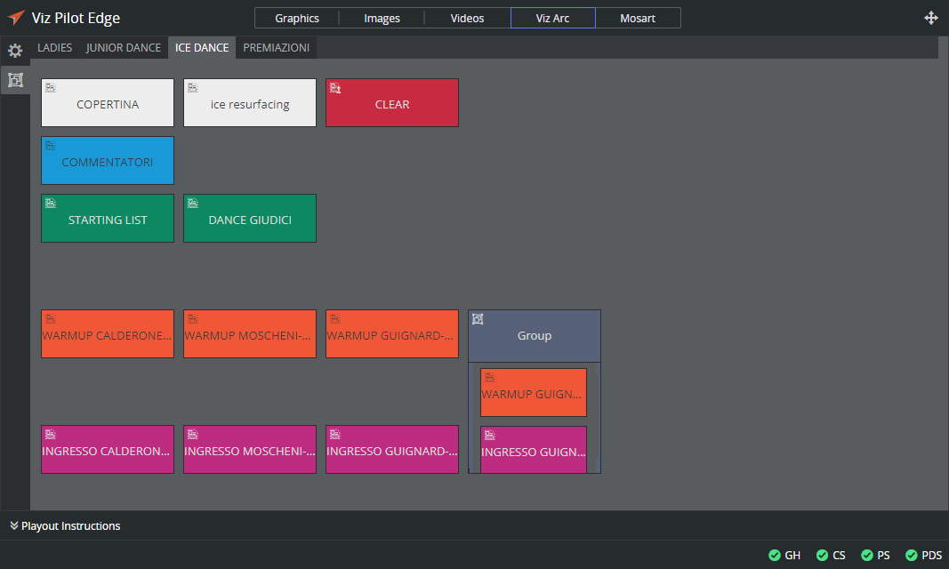

Viz Arc can be integrated with Viz Pilot Edge. In this workflow, Viz Arc actions can be browsed and selected, dragged to the newsroom rundown and played out by a control client like Viz Mosart.

To make the Viz Arc panel appear in Viz Pilot Edge, add the following settings in PDS (see Pilot Data Server documentation on how to add Optional Database Parameters):
Parameter | Mandatory | Default Value if not set | Description |
moseditor_arc_url | yes | The URL to the panel. | |
moseditor_arc_schema | no | http://www.vizrt.com/mosObj/vizarc/action | A unique identifier for the editor to be able to reopen Viz Arc actions from the rundown. |
moseditor_arc_label | no | Viz Arc | Label appearing on the tab in Viz Pilot Edge. |
