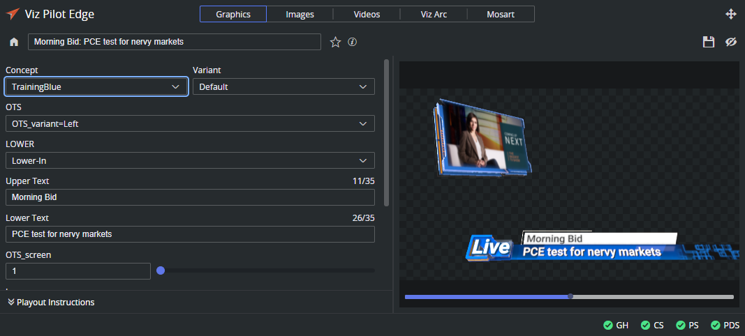

Combo Templates: A TL template that contains more than one layer of scenes. In the screenshot above, the template consists of two layers: OTS and LOWER.
