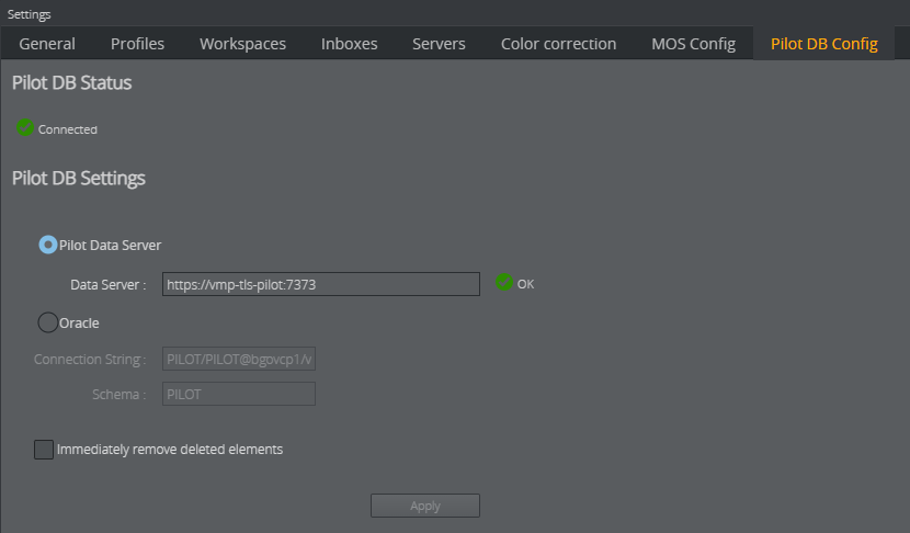

This tab configures the Media Sequencer connection to the Pilot Database. Whenever a reference to a Viz Pilot playlist element is inserted into a playlist in Viz Multiplay, this configuration guarantees that Media Sequencer immediately downloads all relevant data from the Pilot database. The playlist element is then ready for playout through Media Sequencer.
Warning: Switching to playable cache setting from an existing Pilot Data Server with Media Sequencer 5.9 and below will result in losing resolution for existing Pilot elements.
Note: This tab does not support the Cancel button. Any change in this tab takes effect when clicking Apply, and it is not possible to undo by clicking Cancel.
