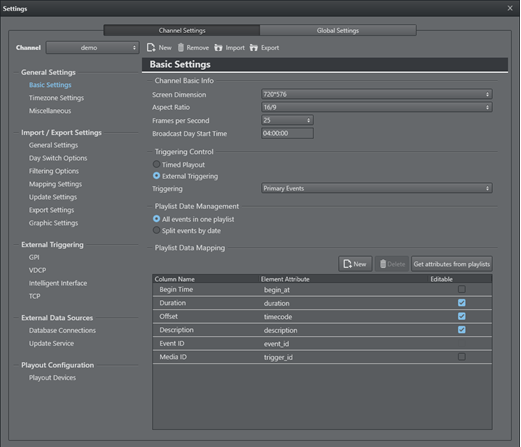

images/download/attachments/72090944/configuration_settingsbutton.png
Viz Multichannel settings are split into two distinct categories: Global and Channels. Channels are the various channels that have been defined by the user in Viz Multichannel.
  • Global settings apply to all channels.
  • Channel settings define the output channels connected to your scheduling system.
    Most of the configuration work is done on a per channel basis. When configuring channel settings, ensure that you have selected the required channel beforehand. Most settings are set using the Settings window.
