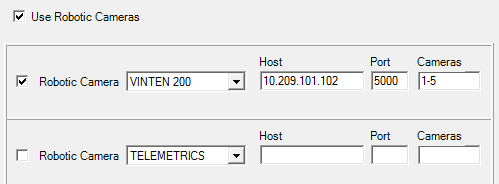

Cameras: List of robotic cameras for individual stand-by control and for matching against the Camera Number in Robotic Camera Control in Template Device Functions. List members are separated by commas, or by hyphens indicating ranges.

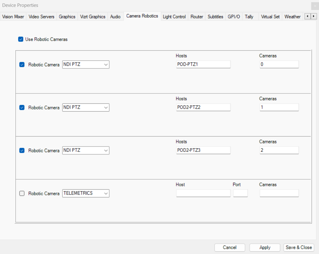

For NDI PTZ, you can configure multiple controllers each with one host:

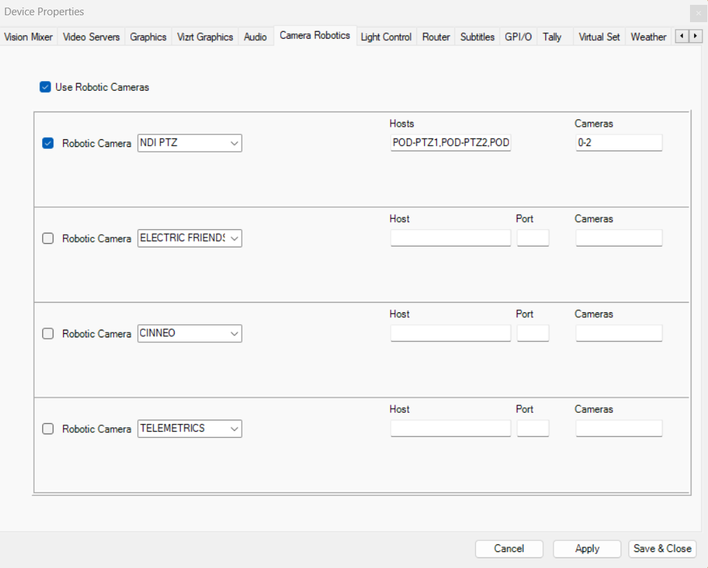

or a controller with multiple hosts. This allows you to use the remaining controllers for other types of robotic cameras:

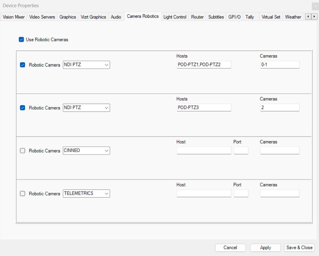

Or you can have combinations like following:
If multiple hosts are configured for a controller, the cumulative status will be shown in AV Automation and Mosart UI. If at least one host which is not in stand-by is not connected, the overall status will show disconnected (red). In the Standby menu in AV Automation however, you can see the status per device.
If, on the other hand, only a single host is configured for a controller (like the second controller in the figure above with Hosts PD-PTZ3 and Cameras 2), the status of that host is shown in AV Automation and Mosart UI.
