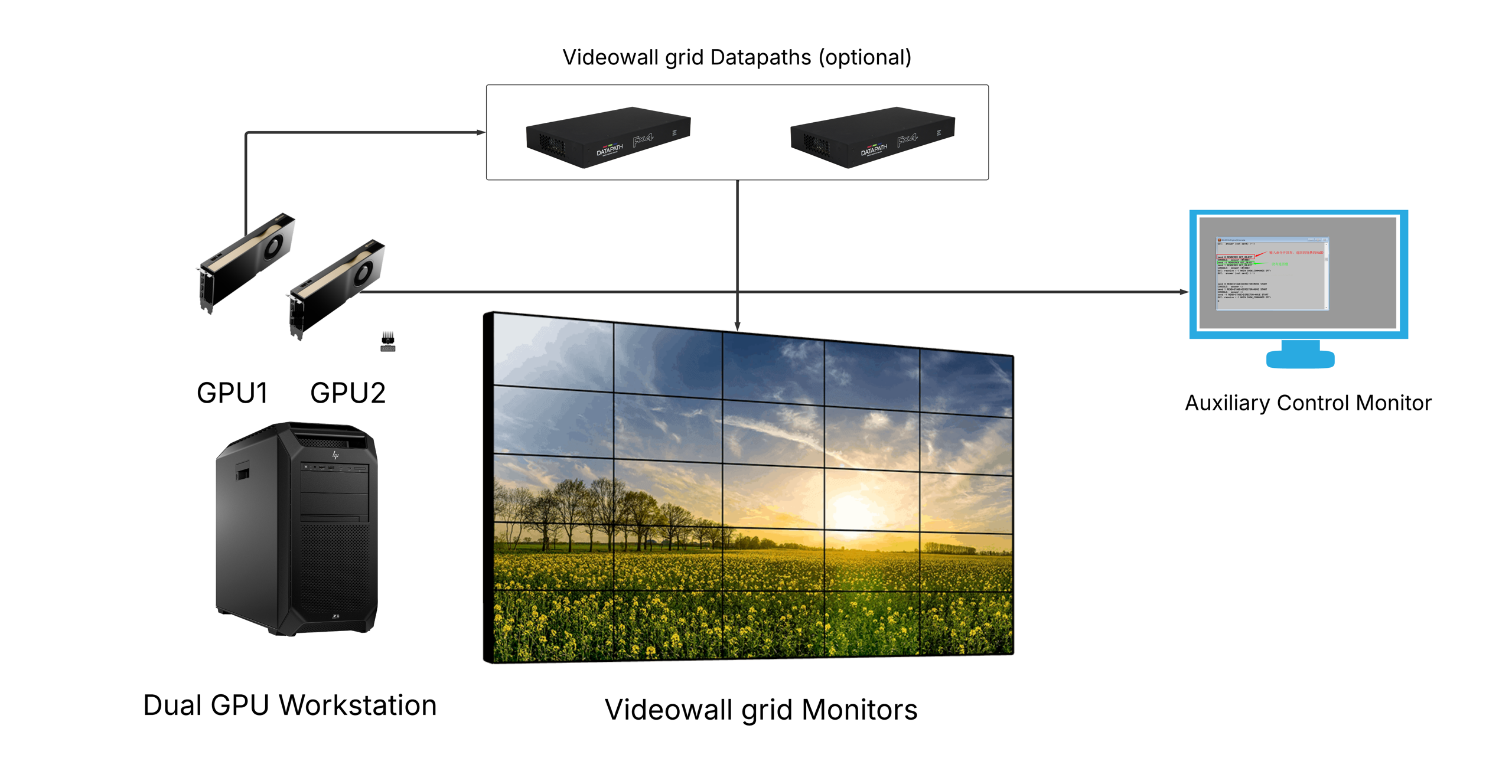

A standard Mosaic video wall setup, using multiple displays connected to NVIDIA GPUs, can be extended with an additional monitor driven by a separate GPU as a control or auxiliary display. This extra monitor operates outside the Mosaic grid, but still extends the desktop, allowing you to run applications, monitoring tools, or system utilities (like a Viz Engine console, performance monitor, or task manager) without interfering with the main videowall content.
Setup Steps
Connect Hardware
  • Connect your primary videowall displays to NVIDIA Quadro GPUs (via Datapath: Optional, in case the number of monitors is larger than the number of display ports).
  • Connect the auxiliary monitor to a separate GPU.
  • If NVIDIA G-sync is used in the setup, make sure it is connected to the grid monitor's GPU.
Note: The GPUs must be from the same family.

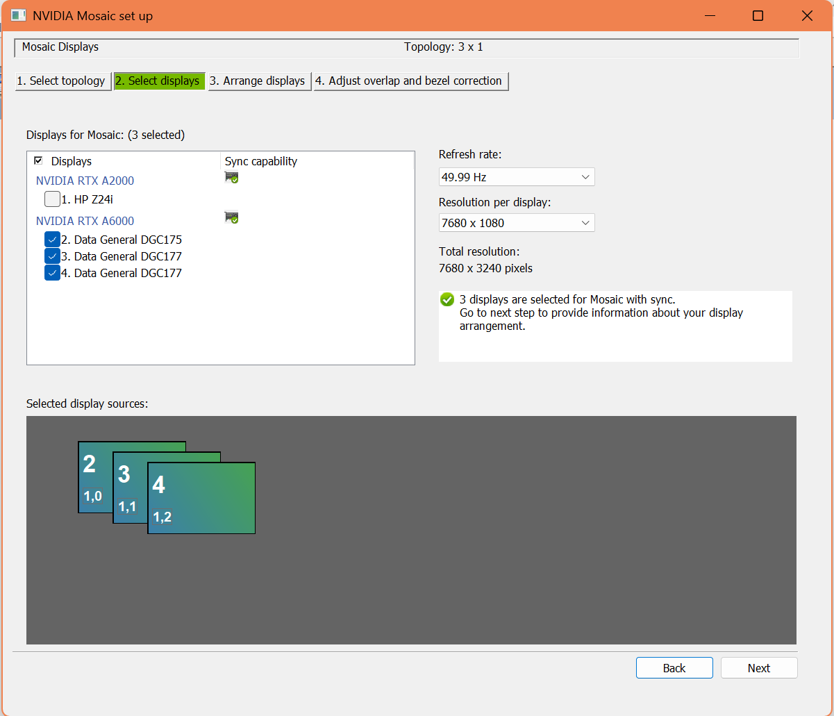

  • Configure NVIDIA Mosaic excluding the additional monitor on the second GPU.

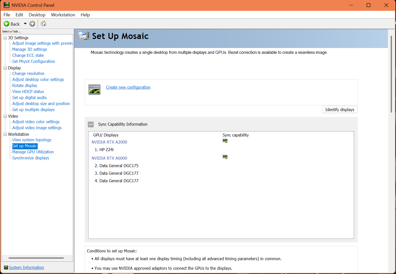

  • Open the NVIDIA Control Panel > Workstation > Set up Mosaic.
  • Select Identify Displays to determine which display is on which output.

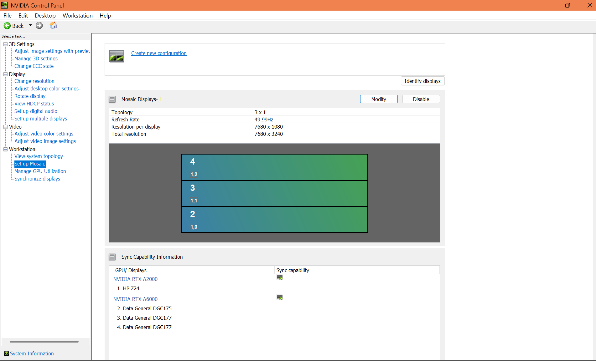

  • Wait for the layout to apply, and the screens refresh (may take a few seconds).
  • Verify that:
    • The Mosaic videowall functions as a unified display, and the mosaic looks as expected.
    • If you are using a G-sync, ensure all monitors are synchronized (Workstation > View System Topology).
    • The control monitor appears as a separate extended desktop, distinct from the mosaic.

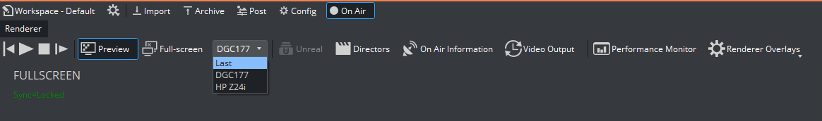

    • When switching to On Air mode, make sure to select the correct monitor
