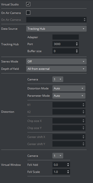

Camera Properties
  • Virtual Studio: Starts the tracking process when Viz Engine is started when set to Active.
  • On Air Camera: Activates the selected camera that should be used when setting the scene in On Air mode. The camera is controlled by an external tracking device.
  • Data Source: Defines the input for the camera:
    • None
    • NDI/SMURF
    • Tracking Hub
  • Tracking Hub: Sets the parameter for the Tracking Hub:
    • Adapter: Specifies the IP address.
    • Port: Enter the port number.
    • Buffer size: Enter the buffer size for Tracking Hub.
  • Stereo Mode (Classic Render Pipeline only): Stereo Mode settings only take effect when the design is taken On Air (license required):
    • Off: Makes Stereo mode unavailable and invisible in the GUI Camera Editor.
    • Quad Buffered: Alternates the image for the left/right eye and darkens the other eye when using nVision glasses together with a monitor with a frequency >100Hz. This configuration provides the full resolution.
    • Over Under Left Top/Over Under Right Top: Draws both images beneath each. Either side can be drawn first. The image height is halved, providing half resolution.
    • Left Eye/Right Eye: Renders either the left or right eye image for dual-channel setups in combination with a Video Wall / Stereo Distributor. Full resolution.
    • Side By Side Left/Side By Side Right: Renders both images side by side, either left or right first. The image width is halved, providing half resolution.
  • Depth of field: Defines from where parameters are taken:
    • Use editor: Gets parameters for depth of field from the editor.
    • Focal plane from external: Gets only the focal plane from the external camera.
    • All from external: Gets all parameters from the external camera.
  • Distortion: Here you can set the lens distortion parameters for each camera individually.
    • Camera: Sets the camera number.
    • Distortion mode: Sets the preferred distortion depending on the tracking system which is used. Available distortion modes are:
      • Auto
      • Internal
      • Libero
      • Xpecto
      • Radial
      • Stype
      • Trackmen
      • ImageBased
    • Parameter mode: Set the parameter for the lens distortion, depending on the tracking system which is used:
      • Auto
      • Libero
      • Manual
      • Tracking Hub
  • Virtual Window: Additional settings for Virtual Window.
    • Camera: Determines the camera to use.
    • FoV Add: Sets an offset of degrees to the tracking data.
    • FoV Scale: Scales the incoming FoV tracking data.
