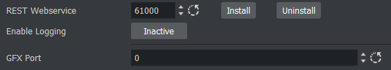

The Viz Engine REST interface can be activated by enabling Webservice in the Global tab of the Communication section of Configuring Viz.

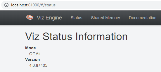

If User Account Control is active, press Install after setting the Port. The default port for the Viz Engine web service is 61000. After restarting Viz, the REST interface can be accessed by navigating a web browser to http://localhost:61000. The landing page displays the status of the Engine, with information on which mode it is running in and its version number.
Once the REST interface has been activated, the complete documentation for the Viz Engine REST interface can be accessed by navigating to http://localhost:61000/#/documentation, or by clicking the Documentation link from the landing page.
