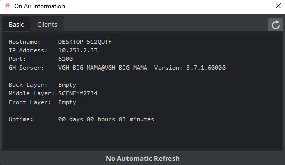

The On Air Information panel shows the required parameters to send external control commands and all connected clients, with the IP address, host name and Viz Port.
Note: Polling for On Air information can decrease the performance. For information on how to adjust the On Air Update Interval, see the User Interface page of Viz Configuration.
Basic Tab
In the Basic tab, the parameters required to send external control commands are shown:
Refresh button: Refreshes the status information.
Hostname: Shows the name external control programs can use to communicate with Viz Artist.
IP Address: Shows the IP address external control commands can communicate with Viz Artist.
Port: Shows the port Viz Artist is using. Default port is
6100, but may be changed in the Communication section of Viz Configuration.GH-Server: Shows the Graphic Hub Manager server Viz Artist is connected to.
Back Layer: Shows the name of the scene that is defined to run in the background of the middle and front layer scene(s).
Middle Layer: Shows the name of the scene that is defined to run in the middle between the back and front layer scene(s).
Front Layer: Shows the name of the scene that is defined to run in the foreground of the back and middle layer scene(s).
Uptime: Shows the time elapsed since Viz was started.

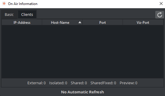

Clients Tab
In the Clients tab, all connected clients are shown with the IP address, host name and Viz Port.
