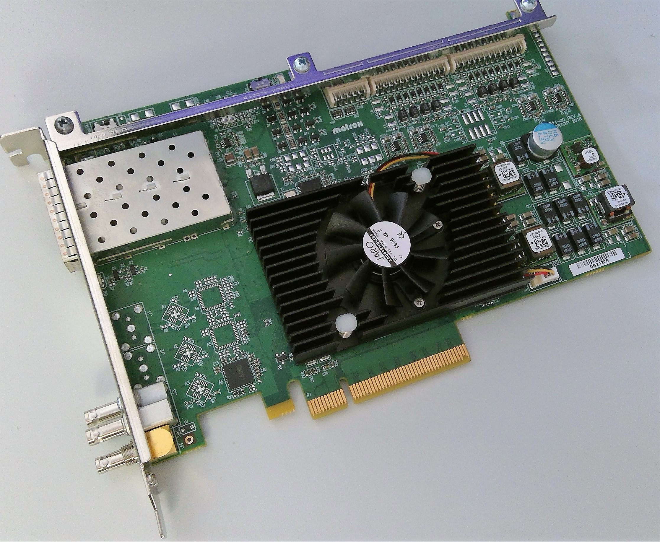

The Matrox X.mio3 12G video board is targeted for the growing UHD market. It is a half-length, full height PCI Express card that offers two 12G SDI inputs and two 12G SDI outputs, using one input and one output module manufactured by Embrionix. The card is based on the original Matrox X.mio3 design and is capable of handling one input and fill/key output, or two inputs and one fill output.

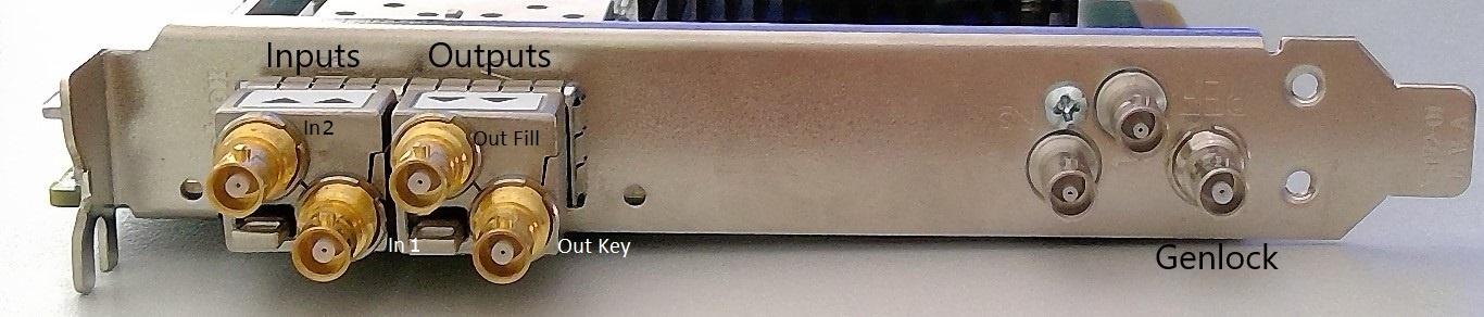

There is one Mini-BNC connector used to connect the card to the house genlock signal. The other two connectors are not implemented.

Half-length PCI Express card.

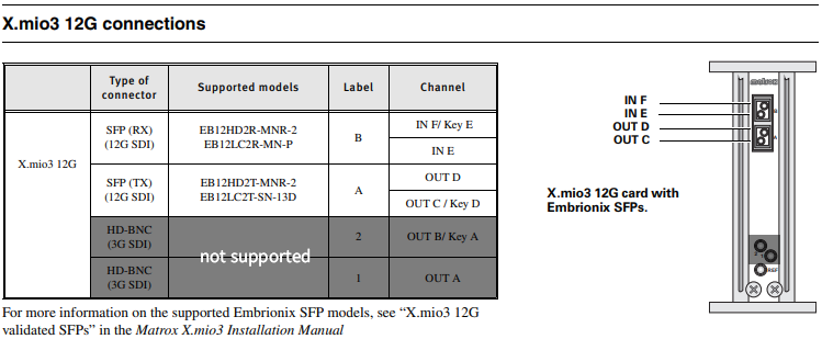

The main video properties match those of a Matrox X.mio3, meaning you can have either one UHD input and one Fill/Key UHD output, or two UHD inputs and one Fill UHD output. Please see Matrox Configuration Section for further details.
Attention: The HD-BNC connectors labeled 1 and 2 are not supported by Viz Engine.

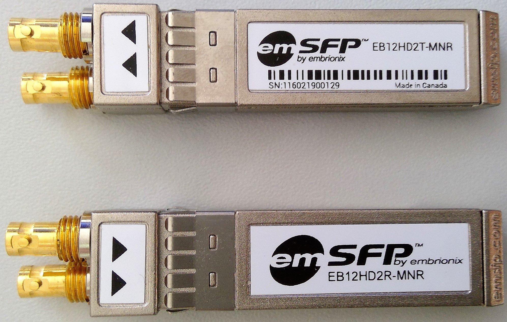

Embrionix SFP I/O Modules
The needed 12G SFPs are available in two flavors, one for input and one for output. To connect to the SFPs standard Mini-BNC cables can be used.
Matrox X.mio3 12G SFP Configuration

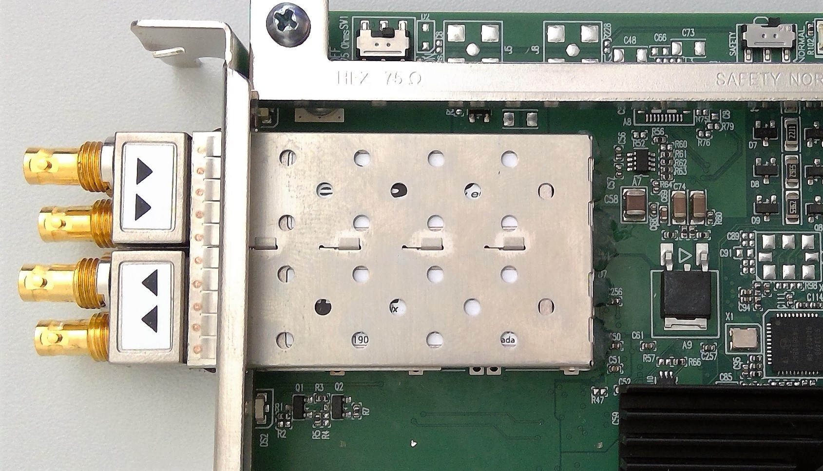

It is important that the seating of SFPs is correct, otherwise inputs and outputs are not available. The output SFP goes into the lower bay and the input SFP into the upper one. See pictures for reference.
