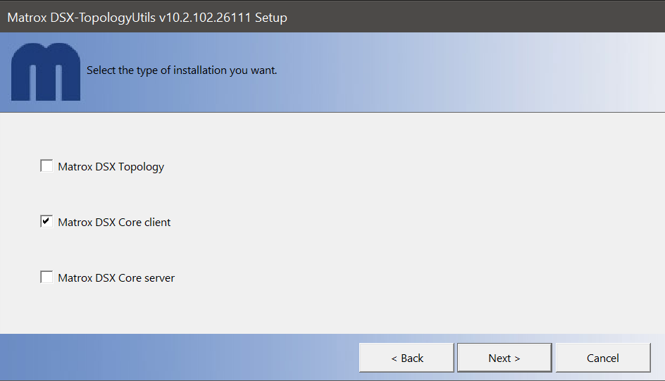

Launch DSX-TopologyUtils.exe.
Be sure to select Matrox DSX Core client:
