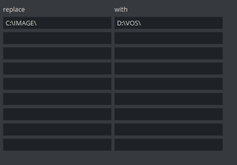

In this section, nine different replacement configurations can be set for image file names.
This can be useful if you need to remap certain locations, and is used by Viz Engine if an image cannot be found at the original location. The given replacements are used from first to last until the image can be loaded.
Replace: Defines the string to be replaced.
With: Defines the replacement string.
Example: If an image file name starts with the string Replace this part of the file name can be replaced by the string With.
