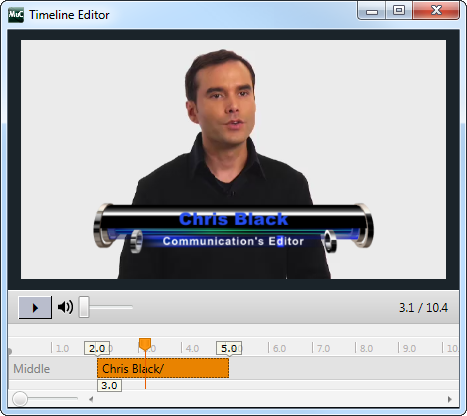

The Timeline Editor allows you to adjust the timing of secondary events under a primary event of a clip.
Add Graphics to the Video Timeline
  1. Open the playlist.
  2. Add a video clip to a primary event.
  3. Drag and drop single or multiple pages onto the video clip.
    When adding graphics on top of video clips you should always make sure you have set Duration beforehand.
    If not, graphics will not appear in the timeline as the default duration is 00:00:00:00.
  4. Double-click the video clip.
  5. Edit the duration or offset of the graphic(s).
    The Duration or Offset of the events in the playlist changes simultaneously.
  6. Close the window.

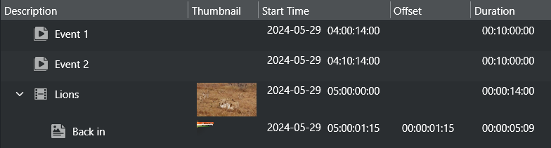

Remove Graphics from the Video Timeline
  2. Expand the video element in the playlist, exposing the time graphics elements.
  3. Select the graphics element and press DELETE, or
  4. Right-click the element and select Remove.
