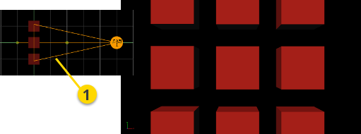

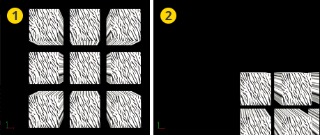

Perspective view shows the basic view of a virtual camera is a normal depth perspective, showing three dimensions.

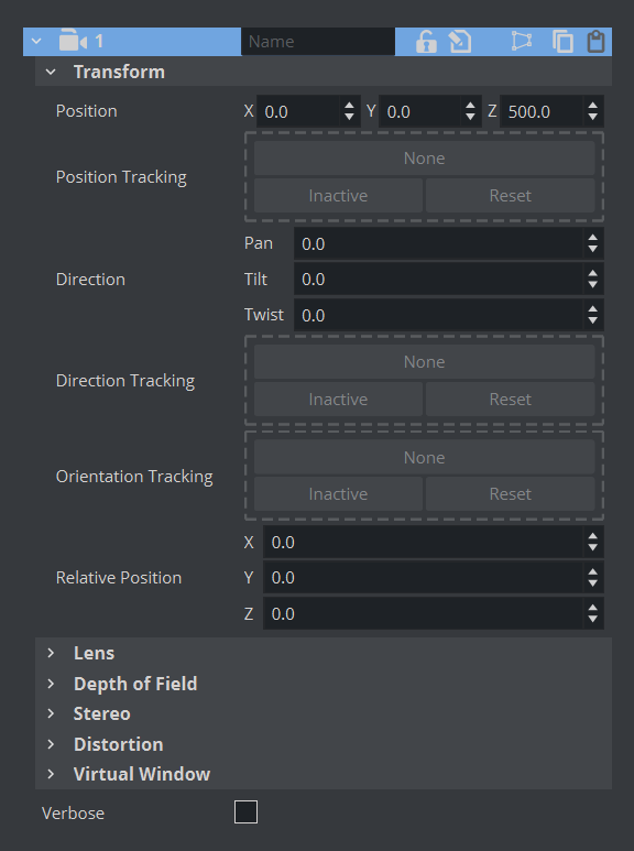

  • Transform
    • Position: Sets the position of the camera along the X, Y, and Z axis. Default setting (1) and modified setting (2).

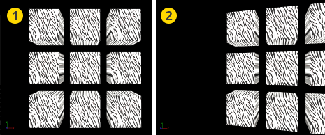

    • Direction: Sets the values for Pan, Tilt, and Twist. Pan set to 0 (1). Pan set to 15 (2).
    • Relative Position: Sets the position of the camera along the X, Y, and Z axis, relative to a real camera. Entering a value in for X, Y and Z axis for the Relative Position changes the actual camera position values, but relative to its orientation.

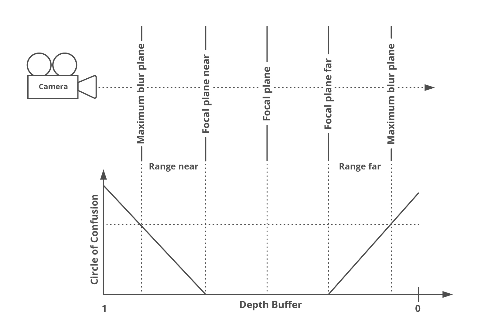

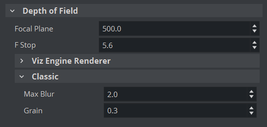

  • Depth of Field
    • Focal Plane: Defines the distance between the camera and objects which are in focus.
    • Max Blur: Sets the size of maximum blur furthest from the camera. For example, a value of 20 signifies that a pixel is enlarged to a size of 20 pixels.
    • F Stop: Sets the F-Stop value (relative aperture): The lens model used by the depth of field algorithm mimics a real lens behavior
    • Grain: Defines the blur level.

Depth of Field (Classic)
Depth of Field (DOF) can be set in the Camera (see the Configuring Viz section of the Viz Engine Administrator Guide) Configuration.
To Set DOF to Follow the Camera Focus
  1. Adjust the Max Blur. This value doesn't need to be higher than 12 to give a good result.
  2. Adjust the F-Stop. Changing the iris also changes the range of depth. Try a value around 10.
  3. Adjust the Grain. This value sets the noise and influences the DOF. Try a value between 0.001 and 0.003.
To Avoid Artifacts
To avoid artifacts, avoid using maximum blur levels which are higher than 30 pixels. A blur radius of 30 pixels creates blurry results which should be sufficient. It is possible to increase this maximum radius, but this also increases the rendering time.
Set the clipping planes in the range you really need for the scene. So if your scene has only a depth of 200, set the far clipping plane to 250 or a similar value. Since the depth of field shader takes the depth from the depth buffer, this gives more accurate results. Try to avoid high blur levels for objects before the focal plane, as this can cause unwanted effects. You can increase performance, but artifacts would show for blur levels lower than 30px.

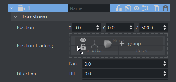

Tracking
A camera can be set up to track the Position, Direction or Orientation of a Container.
  • Position Tracking: The position of the camera is the same as the target containers position.
  • Direction Tracking: The rotation of the camera is updated to always point towards the current position of the target container.
  • Orientation Tracking: The rotation (orientation in space) of the camera is the same as the target containers rotation (orientation in space).
Note: Direction and Orientation tracking cannot be used at the same time. The results would contradict each other (both of them result in a potentially different rotation value for the container).
  • Active/Inactive: Drag a container to the drop zone to automatically enable camera tracking. To disable tracking, click the Active/Inactive button.
  • Reset: Disables camera tracking.
