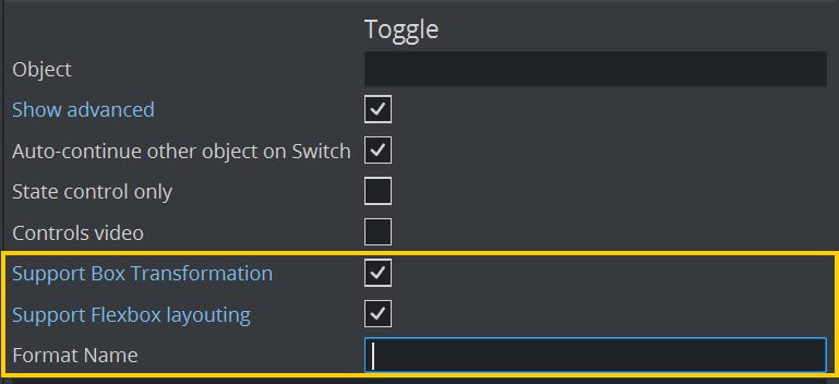

Support for Adaptive Scenes (Box transformation) was added into the Toggle plug-in from Viz Engine 5.4. It requires the use of Subscenes, merged geometries are not supported to be used with box transformation scenes.
The following options have been added to the Toggle plug-in:
  • Support Box Transformation: Enables the use of adaptive scenes within the Toggle plugin. Enable if you have Box Transformation used in leaf scenes.
  • Support Flexbox layouting: Forces the Toggle plugin to handle the layouting capabilities of Flexbox plugin to match the required toggle functionality. Enable if you have the Flexbox plugin used in leaf scenes.
  • Format Name: Forces the Toggle plugin to render the used subscene in a certain format. If none is provided, the format of the master scene is used.
Note: After setting these values, the scene needs to be saved and reloaded to add proper Toggle structure.
