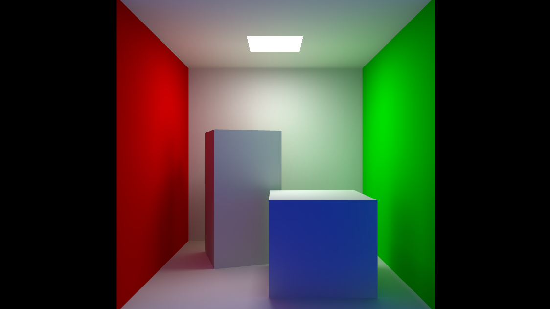

Global Illumination is a rendering technique that attempts to mimic real-world lighting behavior, taking into account that objects are illuminated by direct light (direct illumination) and receive/reflect/bounce light themselves from their surroundings (indirect illumination).
The Global Illumination solution used in the Viz Engine Render Pipeline is an improved version of the one introduced with Viz Artist 3.9. Major enhancements have been made to increase the realism of the generated output. It relies on precomputed lightmaps to generate indirect lighting. Those lightmaps are updated at runtime when light conditions change.

The scene used for the screenshot does not include any light in the scene, the whole lighting is calculated by the GI using the emissive property of the rectangle on the top of the box and ambient occlusion texture:
Screenshot | |
Albedo Material Texture | Emissive Material Texture |
