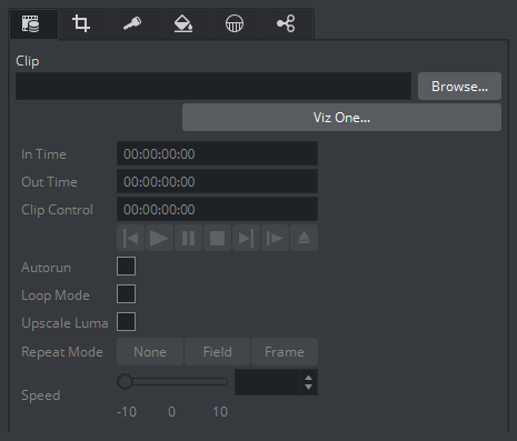

In addition to the common Media Asset properties, Video Clip also has these properties:
Clip: Selects the video clip to be shown:
In the Clip line, click Browse, or
Drag a Video Clip item from the Server Panel, or
Click the Viz One button, and select a video clip to import.
In Time: Sets the video clip ‘in time’.
Out Time: Sets the video ‘out time’.
Clip control: Shows player controls for the selected clip.
Autorun
Off: Presents the first frame as soon as the video clip is loaded.
On: Begins playback as soon as the video clip is loaded.
Loop Mode
Off: Plays the video clip once.
On: Plays the video clip in a loop.
Upscale Luma
Off: Uses the key as is.
On: Upscales the key information from
16-235to0-255.
Repeat Mode
None: Plays back black frames when the clip is in an erroneous state.
Field: Plays out the first field of the last frame when the clip is paused.
Frame: Plays out the last frame when the clip is paused.
Speed: Controls playback speed.
1.0is the normal speed. Values between0and1.0are forward playback in slow motion. Values above1.0are forward playback in fast motion. Likewise, values between0and-1.0are reverse playback in slow motion. Values less than-1.0are reverse playback in fast motion.
