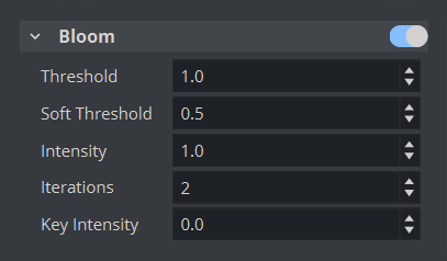

The settings for the Bloom Effect are located in the Scene > Rendering Menu:

Parameters
Parameter | Description |
| Defines the basic brightness threshold. A pixel that is below this threshold is not used in the blur steps. |
| Additional threshold to soften the pixel selection instead of a hard-cut. |
| Scales the bloom image colors before adding it to the original image. |
| How many render passes are used to calculate the boom. Higher value means higher quality. |
| Specifies how much of the effect is used within the key signal. |

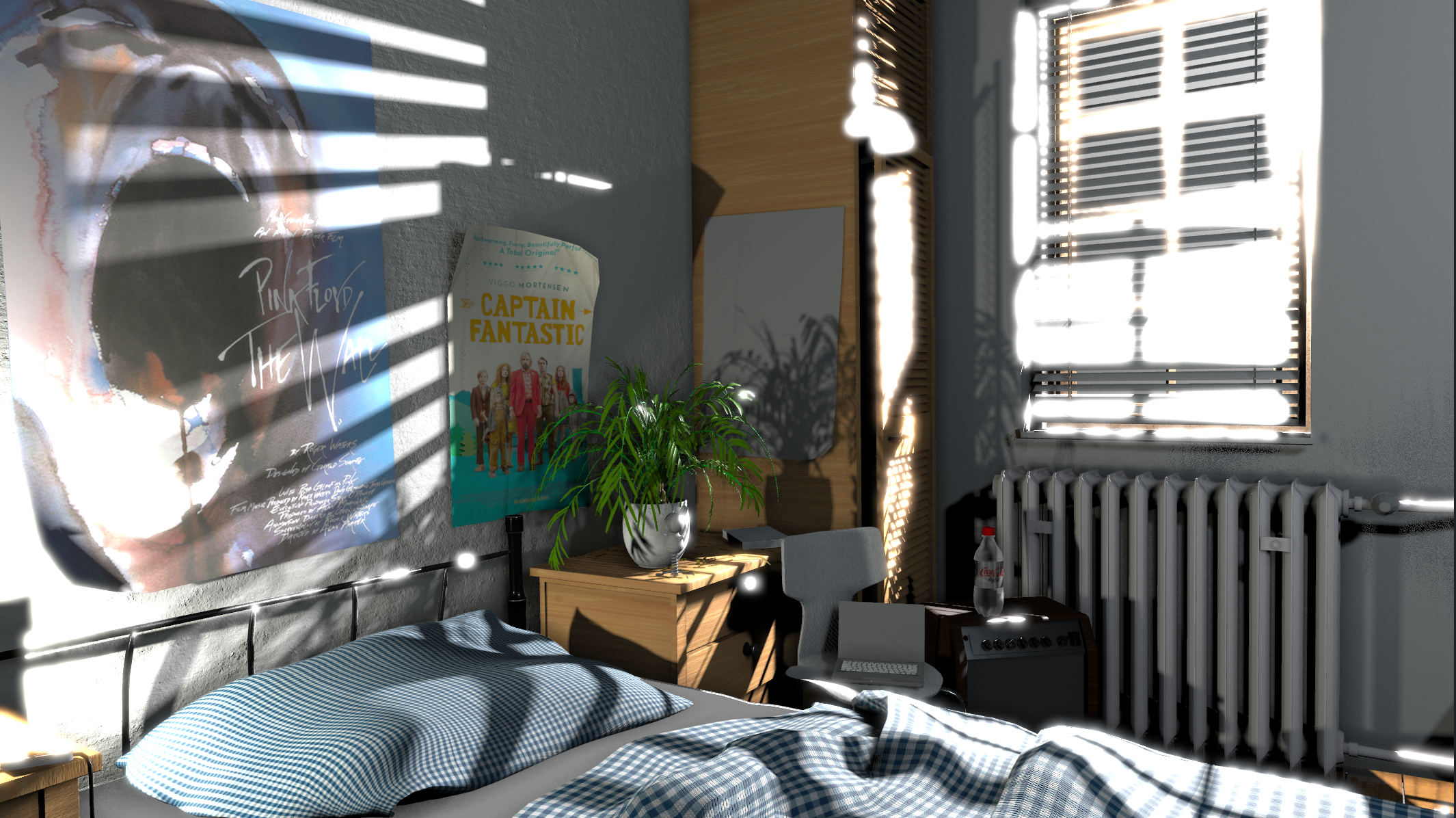

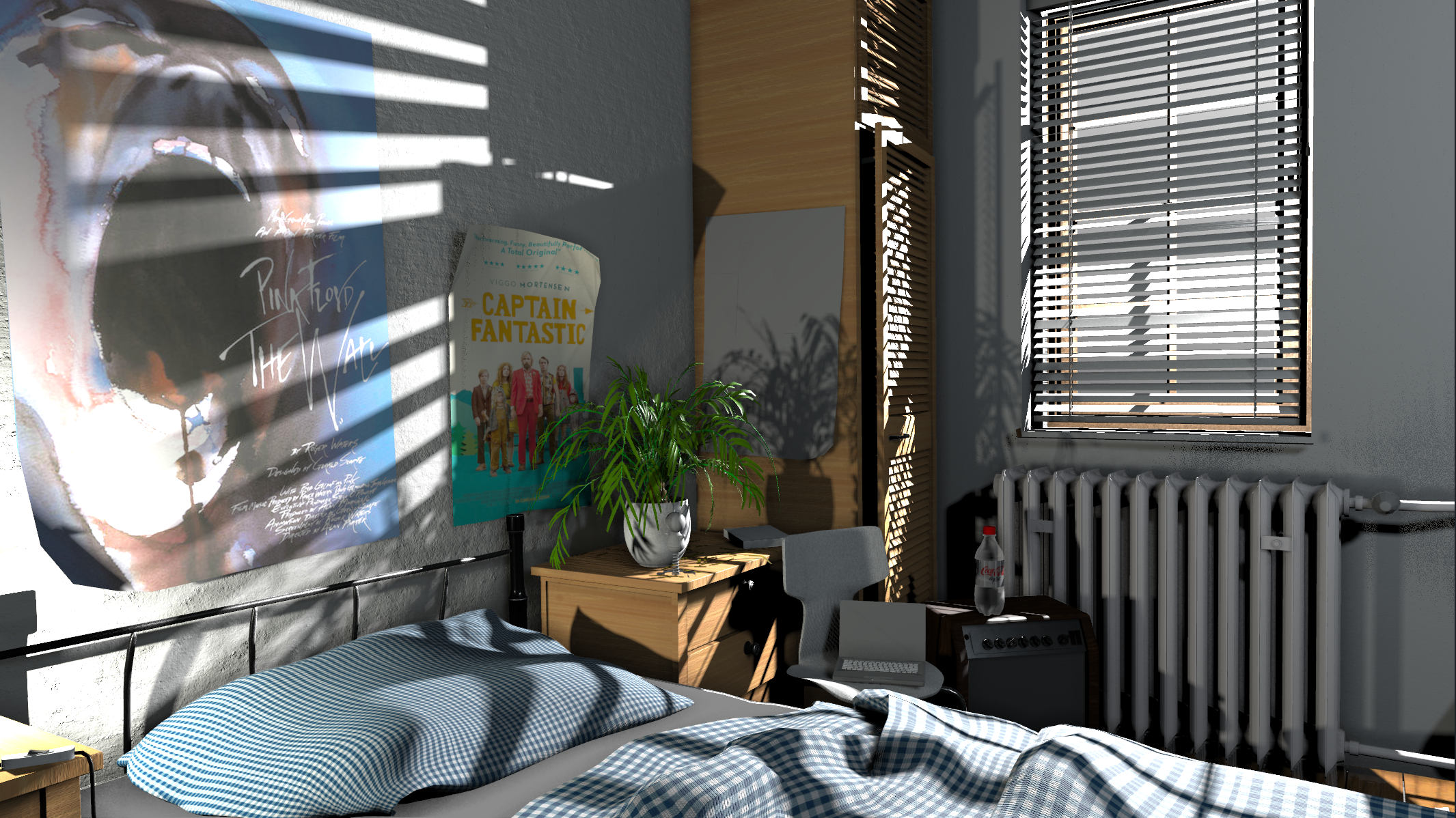

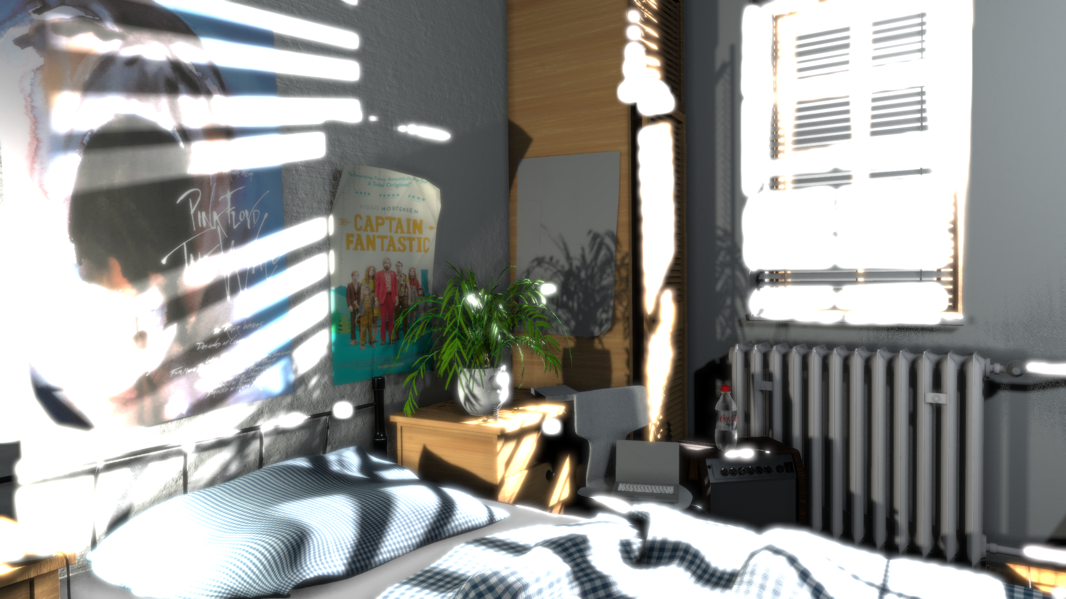

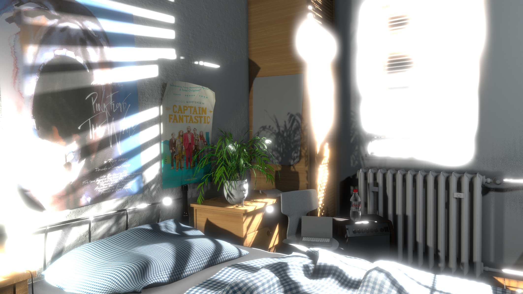

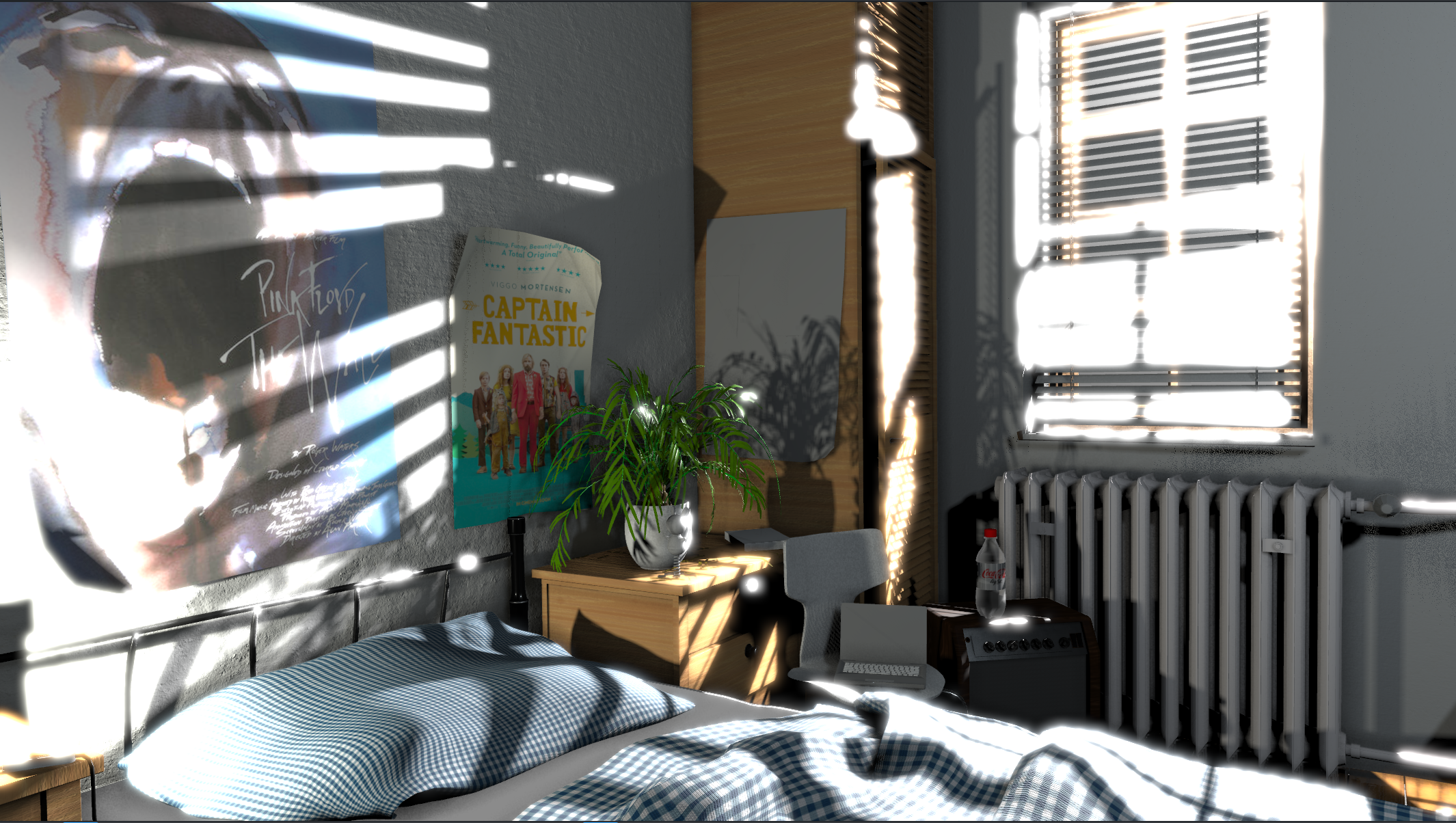

Screenshot | Bloom Settings |
Bloom Disabled | |
Bloom Enabled
Bloom Enabled
Bloom Enabled
Bloom Enabled
