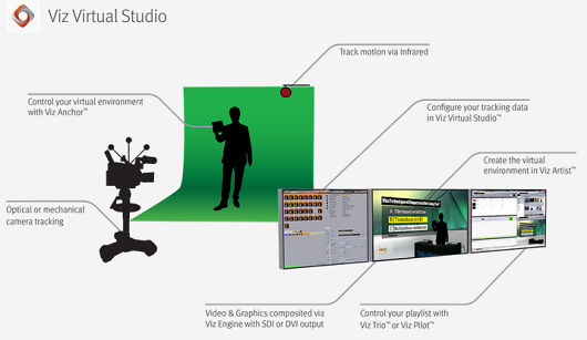

The Viz Virtual Studio provides a perfect match between real and the virtual scene elements. The reality is a compromise between the technical possibilities and the perceptual ability of the audience.
This manual gives a description of Tracking Hub and Studio Manager.
This release gives a limited feature set. Not all tracking devices, routers and GPI devices are implemented yet. The features of the Cyclorama (Cyc) Editor are limited. If more complex geometries are needed, or obstacles should be masked out, this needs to be done in the front layer of the Viz Engine.
