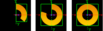

The Ring plug-in creates an open or closed ring with some attributes.
Ring Properties
Use LOD: Enables/disables dynamic level of detail.
Corners: Sets the number of corners on the ring.
Inner Radius: Sets the size of the inner radius.
Outer Radius: Sets the size of the outer radius.
Rotation: Rotates the ring like a “turning wheel”. This is typically used in combination with an open angle, to place the angle at the required point.
Angle: Defines an open angle on the ring.
Mode: Changes the object view coordinate. Available options are XY, XZ and YZ.
To Create a Ring
Create a new group and add the Ring plug-in to it.
Add a material and/or a texture to the group.
Open the Ring plug-in editor and animate the Angle.
Set Angle to
0.0(60/50 fps).Set Angle to
360.0(120/100 fps).
