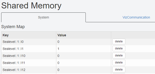

SHM Interface
Each GPIO pin is mapped to a SHM key.
Format
The pins are mapped with following format:
Inputs:
Sealevel::<device-id>::I<pin-id>::<0 or 1>Outputs:
Sealevel::<device-id>::O<pin-id>::<0 or 1>
SMM Values in Viz Engine REST Interface
Inputs
These SHM values are only for reading and are updated when a input pin changes. By registering to SHM changes this can then be used to perform tasks in scripting or plug-ins.
Outputs
These values are meant to set from inside scripts or plug-ins (for example to switch lights on and off).
