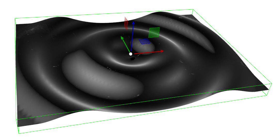

To Create a Wave
Create a new group and add the Wave plug-in to it.
Open the Transformation Editor and set Rotation X to
-75.0.Add a material and/or a texture to it.
Open the Wave editor and set the following parameters:
Set Size X and Y to
350.0.Set W.-Length to
8.0.
Click the Lock button to unlock the spline curve editor.
Play with the spline curve handles, Time, Position X and Y values to see how the wave behaves with different settings.
