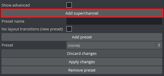

The preset scene manages named presets that define layouts of Super Channels. We need to add Super Channels to the scene. Super Channels can be added to the scene one by one with the plug-in:
It is possible to add Super Channels to the scene manually in the DVE media assets tab, however this is discouraged because the default Super Channel configuration does not support playout from the Media Sequencer. The following settings are set when adding Super Channels with the Presets plug-in:

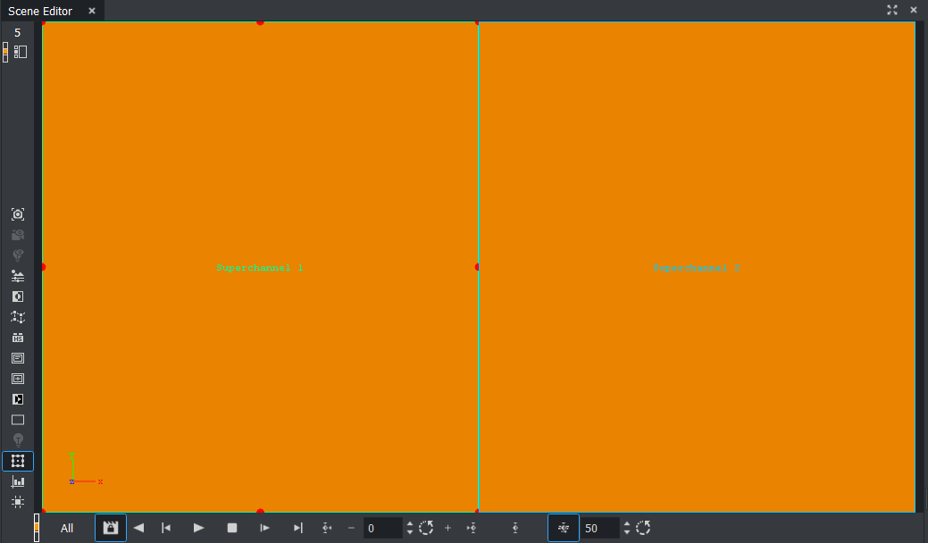

To create a new preset, first arrange the Super Channels to the desired layout and set the desired Super Channel properties:

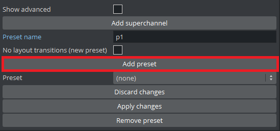

When the desired layout is set, use the Presets plug-in interface to add a new preset:
Specify a unique name for the new preset before pressing the Add preset button. Existing presets are not overwritten. For adding more presets to the scene, repeat the process of adjusting the Super Channel layout, choosing a new preset name and pressing the Add preset button. If it is desired to add a preset without layout transitions to and from other presets, the option No layout transitions (new preset) should be enabled before pressing the Add preset button.

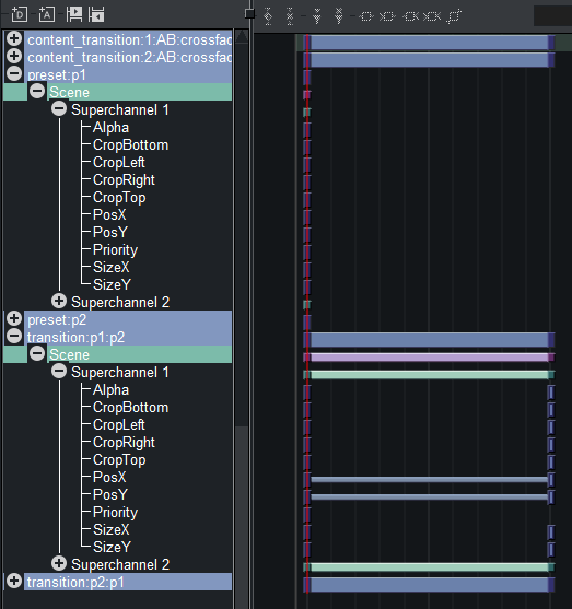

The presets and transitions between presets are now represented by directors in the stage, created by the plug-in:

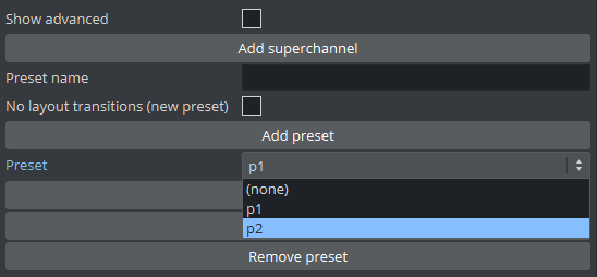

To edit a preset, first make sure it is selected in the dropdown list:
Now you can rearrange the Super Channels to the desired layout.
