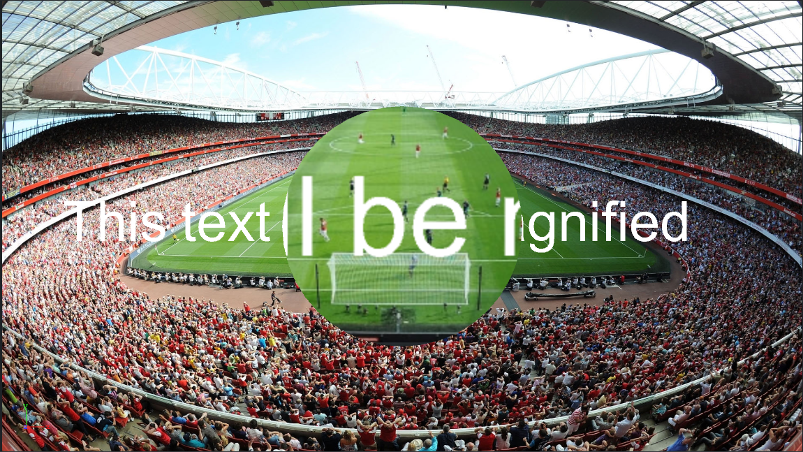

The Magnifier plug-in enlarges certain areas of the render output. Magnifier magnifies all underlying graphics.
Create a container and drag Magnifier onto it.
It automatically magnifies the underlying parts. It can be used multiple times (in contrast to the scene magnifier functionality).

  • Type: Defines the basic shape of your loupe. It can be either a rounded circle or a square rectangle shape.
  • Position: Defines the location of the magnification. This can be either defined in Magnifier by modifying the x and y parameters or you use the attached containers position by activating the Use container position option.
  • Size: Defines the location of the magnification. This can be either defined in Magnifier itself or you use the attached containers scale by activating the Use container scale option.
  • Scale: Determines the magnification level.
  • Ellipsis: Defines how much distortion the lens has.
  • Color: Defines the color of the magnified area. The color is additively blended.
  • Alpha: Gives your magnifier a smooth border. A value of 1 gives a sharp edge and the lower the value, the smoother the edges are.
  • Tesselation: Defines how exact the loupe is build. A value higher than 20 does not make any sense and provides no visual improvement.
