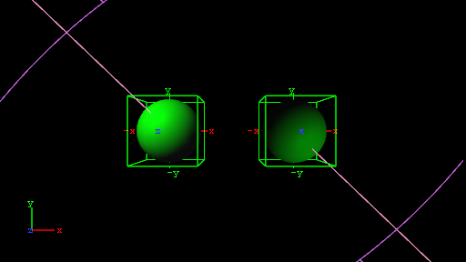

To Add Light
Open the Light Editor, and disable global light settings.
Add a Sphere geometry to the scene tree, and add material and Lighting to it.
Duplicate the Sphere container and place it at the same level (root) as the other container.
Open the transformation editor and set Position X to
-100.0
for the first container and Position X to100.0
for the second.Open the Lighting editors the first container one and set the following parameters:
Set Type to
Spot
.Set Light Color to
0,255,0
Open the Lighting editors the second container one and set the following parameters:
Set Type to Spot.
Set Light Color to
0,255,0
.Set Position X and Y to
650.0
and-850.0
, respectively.Set Rotation X and Y to
-650.0
and850.0
, respectively.
