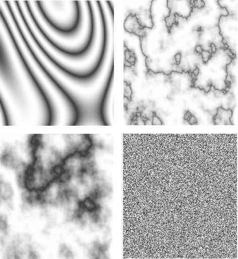

Noise: Sets the values for the sections that are computed based on user-defined noise map created using noise algorithms (perlin noise).
The settings create a noise texture and the image transformations are based on this image.
When you edit the noise properties it is a good idea to enable the show button. This lets you see the images that are created and see changes instantly.
Wave, Cloud, Marble and Noise are predefined noise parameter settings. It is normally a good idea to start with one of these and thereafter edit until you get the required effect. The four images below show how the four noise parameters look like when the show option is enabled:
Turbulence 1 to 3: Sets the noise level. The settings must be played with to see what kind of effect you get as they influence each other. So what effect one gives depends on the state of the other.
Frequency: Defines something that can be described as the “wave length” of the noise function. A large number gives a small wave length which creates a lot of changes to the image, while a small number creates a smoother image.
Exponent: Controls the ratio between the white areas and the black areas without changing the shape significantly. Exponent zero give a full white picture, and as the value grows, the black area becomes larger and larger.
Scale X/Y: Are quite similar to the usual texture scale, but they are working with reverse logic. In the usual texture scaling, increasing the scale is like zooming into the image, but in Image FX it works like zooming out. Also the units are different, but beside this, they are quite similar.
