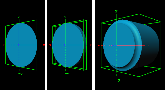

The Extrude plug-in sweeps a 2D item through space along its Z-axis. The sweeping path the item is followed during this process is used to create a surface. As a result a 3D item with front, back and sides is created from the 2D item.

To Extrude a 2D object
Create a group and add a Circle and material to it.
Add Extrude to the same container.
Open the Extrude editor and select one of the bevel effects, and set Extrusion depth to
100.0and Bevel Size to10.0.
