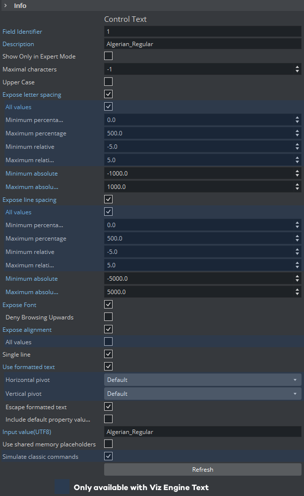

Control Text Properties
Maximal characters: Sets the maximum number of characters which can be typed into the text field.
Upper Case: Converts lower case input into upper case when set to
On.Expose letter spacing: Allows changes to the letter spacing parameters and sets the minimum and maximum value when set to
On. The exposed field is kerning.All values *1: Exposes two more values of letter spacing, percentage and extended relative instead of just extended absolute. The exposed field is changed to a group of three sub-fields:
letter_spacing.percentage, Minimum and Maximum value can be set.
letter_spacing.extend_rel, Minimum and Maximum value can be set.
letter_spacing.extend_abs, Minimum and Maximum value can be set.
Expose line spacing: Allows changes to the line spacing parameters and set the minimum and maximum value when set to
On. The exposed field is line_spacing.All values *1: Exposes two more values of line spacing, percentage and extended relative instead of just extended absolute. The exposed field is changed to a group of three sub-fields:
line_spacing.percentage, Minimum and Maximum value can be set.
line_spacing.extend_rel, Minimum and Maximum value can be set.
line_spacing.extend_abs, Minimum and Maximum value can be set.
Expose Font: Allows selects another Font when set to
On. The exposed field is font on Classic Text, or font_face on Viz Engine Text.Deny Browing Upward:
Expose alignment: Allows changes to the text alignment when set to On. The exposed field is justification.
All values *1: Exposes both horizontal and vertical alignment. The exposed field is changed to a group of two sub-fields:
alignment.horizontal
alignment.vertical
Single Line: Converts multi-line input into a single line when set to
On.Use Formatted Text: Enables use of character specific formatting in supported client applications. Character specific formatting includes bold, italic, subscript, superscript, kerning, position, rotation, scaling, alpha, and color(RGB) in Classic Text, modifier, font size, color(ARGB) in Text. Formatted text cannot be used together with Text FX Write.
Horizontal Pivot and Vertical Pivot: Set transformation pivot of characters in Formatted Text Wrapper with this formatted text
<fo:wrapper rotate-z="-45">M</fo:wrapper> <fo:wrapper scale-x="2" scale-y="2">N</fo:wrapper>. Set Horizontal Pivot to Center and Vertical Pivot to Middle rotates ‘M’ and scales 'N’ at the original center of each character.To use the characters
<and>correctly in Viz Multichannel, make sure that Use Formatted Text is set toOFF.Character specific formatting is not supported for Viz Pilot.
In Viz Trio, the operator enter a required formatting mode via an assigned shortcut key. To change the format of one or more characters, hold down ALT and toggle the right and left arrow keys to shift mode. See the Viz Trio User Guide for more information on Character Formatting.
Escape formatted text: Simplifies formatted text output. Use XML escape characters instead of XML <![CDATA[]]> and not add an XML root element. Use
<fo:wrapper/>element only with formatted words and characters. Control Text still accepts both full formatted and escape formatted text input independent of this property.Include default property values: Adds all available properties of formatted text output even all values are defaults. This guarantees all supported formats by Control Text can be transferred to another Text via XML.
Input Value / Input Value(UTF8): Shows the current value for the plug-in. It is not necessary to set any value here. It is used for debugging purposes.
Simulate classic commands*1: Allows Viz Trio uses Classic Text commands via Control Object to control styles of Viz Engine Text.
*1: only available with Viz Engine Text
