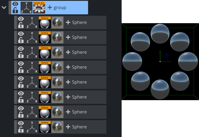

To Arrange Containers in a Circle
Create a group container, and name it
Circle.Add a Sphere as a Sub-Container to the Circle container.
Add a material and/or a texture to the Sphere container.
Open the Transformation Editor for the Sphere container, and set Scaling (locked) to
0.2.Optional: Animate the Sphere object.
Make 15 copies of the Sub-Container, totaling the number of Sphere containers to 16. All copies should be placed as Sub-Containers of the Circle container and have the same position as the original.
Add the Circle Arrange container plug-in to the Circle container.
Open the Circle Arrange editor and do the following:
Set Number of items to
16.Set Number of Rows to
2.
Click the Rebuild Container list button. The plug-in positions all Sub-Containers in a circular structure. The order of the containers in the group decides their placing in the circular structure. If more than one row is selected, the first containers end up in the outer circle and the last containers in the inner circle.
