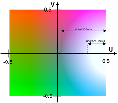

The color-space of this Shader is YUV, which is defined as following:
The luminance (Y) component determines the brightness of the color, while the U and V components determine the color itself (the chroma). Luminance (Y) ranges from 0.0
(dark) to 1.0
(bright). U and V ranges from -0.5
to 0.5

Basic parameters for second method:
U-Color: Determines U-value for color keying.
V-Color: Determines V-value for color keying.
UV-Diameter: Removes all colors between the reference UV and this diameter.
UVGradient: Determines gradient for fade out at diameter border (
0
=sharp,1
=soft).
