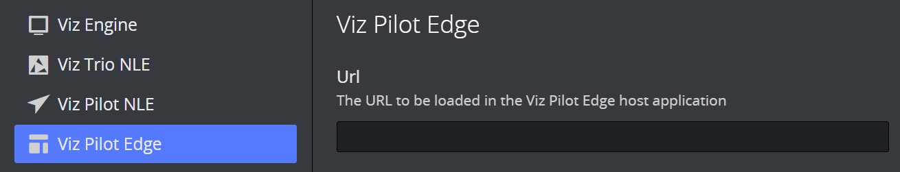

HTTP
When using HTTP, the URL path must have a value. To configure this, go to the Graphics Plugin Configuration tool and select Viz Pilot Edge from the settings view drop-down.

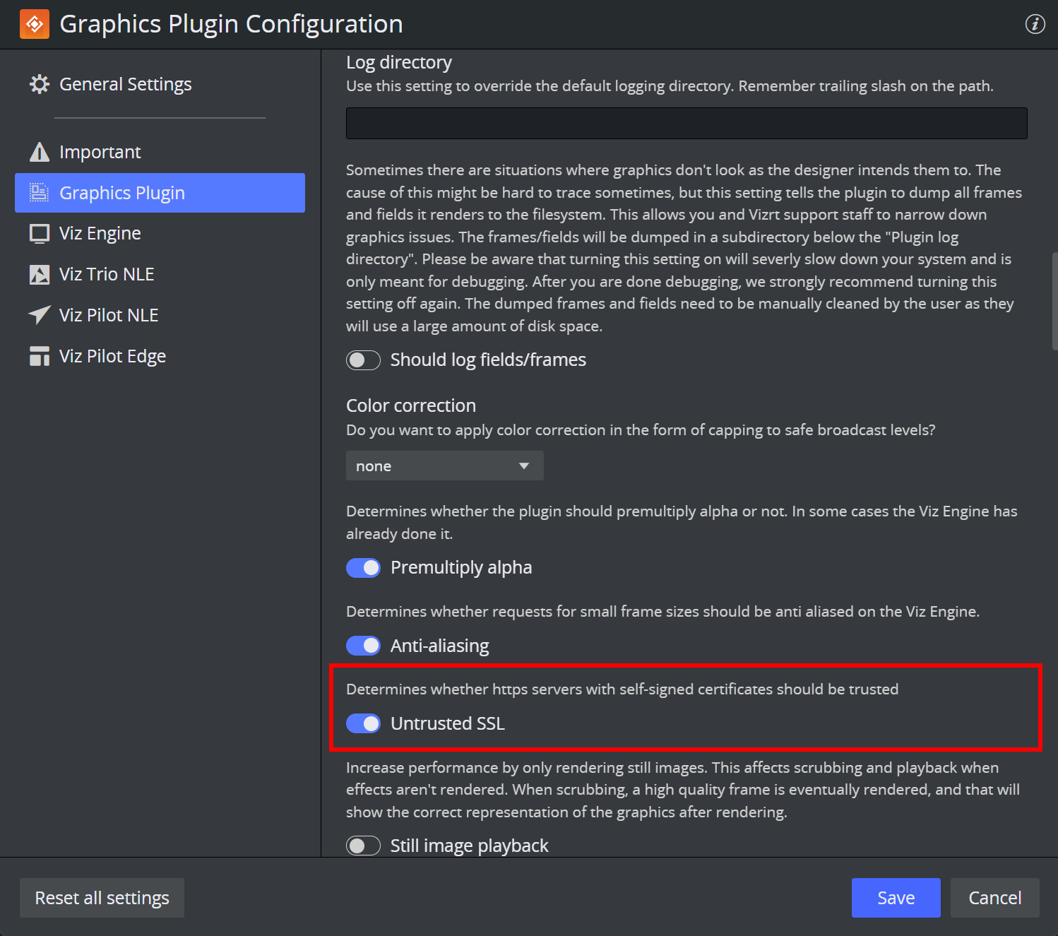

To use HTTPS, besides defining the URL, it is necessary to do the following:
  • Use the appropriate (or newer) Graphics Plugin versions:
    • Adobe: 2.3.2
    • Avid: 2.3.2
    • Edius: 2.3.1
  • Install the appropriate certificate on the Trusted Root Certificate Authorities:
  • On the Graphics Plugin Configuration tool, go to Graphics Plugin and check the Untrusted SSL option.
