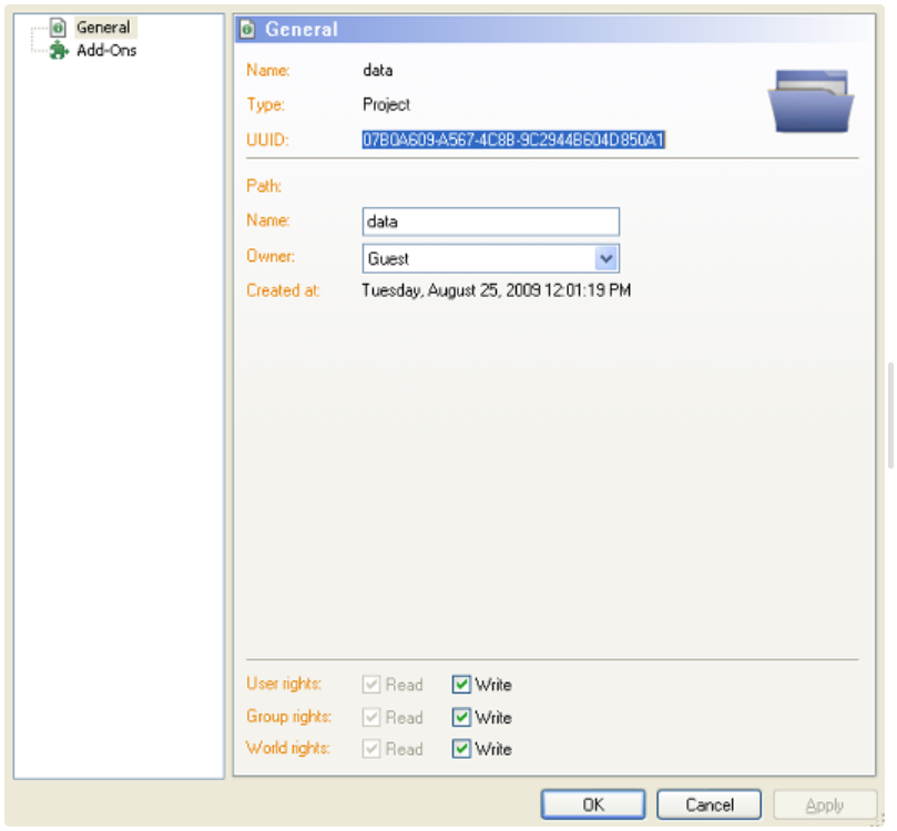

  2. Open the properties of the data directory on both machines (right-click the data folder, and then from the menu that shows, select Properties), and make sure that the UUIDs on both machines are identical. If they are not identical, shut down the servers.
    1. If the data directories on both the Main and Replication servers are empty, delete both data directories. Use the Graphic Hub Terminal to create new data directories on both servers, then start the cluster.
    2. If the data directory is not empty, delete the data directory on the Replication server only. Copy the data directory from the Main server to the Replication server. Use the Graphic Hub Terminal to configure the copied data directory as a new data directory for the Replication server, then start the server. To use the data directory on the Replication server as data directory for the cluster, repeat the above steps copying the data directory from the Replication server to the Main server, and configure the main server with the copied data directory.

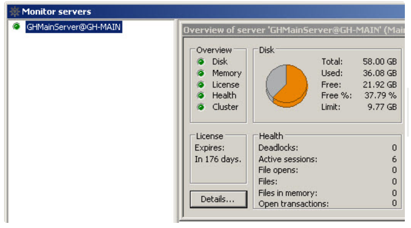

  3. In Graphic Hub Manager, select Tools > Monitor Servers . Check that the Health LED is green.

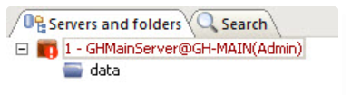

  5. Unplug the network cable on the main machine, and then wait for a few seconds.
    The Graphic Hub Manager chat panel should show that the main server is down and that the replication server has automatically taken over.
    The main server name in the Servers and Folders should also be colored red.
