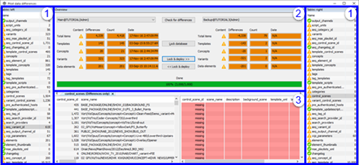

The Pilot differences window in the Graphic Hub Manager is used to view and resolve differences in Viz Pilot data between two or more Graphic Hub servers. This can be the main and replication servers in a cluster environment, or other Graphic Hub servers that contain Viz Pilot data, such as a backup server.
To Check for Viz Pilot Data Differences
  1. In Graphic Hub Manager, log on to the servers that you want to compare.
  2. Click Pilot > Differences… to open the Viz Pilot data differences window.
  3. Select the servers to compare in the Overview section, then click Check for differences. This compares the Viz Pilot content on the selected servers, and you can now perform a manual backup or resolve potential cluster differences.
Understanding the Viz Pilot Data Differences Window
  • Tables left/right (1): The two panes Tables left and Tables right show a listing of all database tables that are compared between the two servers.
  • Overview (2): The Overview pane provides a quick overview of the differences between two servers:
    • Drop-down menu: If the Manager is logged on to more than two servers, all servers are selectable from the drop-down menus to the left and right of the Check for differences button.
    • Check for differences: Click to compare the selected servers. This initiates a checksum-based comparison of the table data between the servers. In the left and right panes, identical tables are marked with a green check mark icon. Tables that differ are marked with an orange warning icon. The Overview is populated with a summary of the differences. Any changes made after the last click are indicated by a counter, and a timer indicates the time passed since the latest change.
    • Lock/Unlock database: Click to lock or unlock the databases. When the database is locked, read operations are permitted, while write operations are not. Locking the databases starts a timer that shows how long the database has been locked, and the button changes to Unlock database.
    • Lock & deploy << | >>: Use lock and deploy to lock the databases for changes and deploy any elements required to bring the two servers into identical states. The arrows indicate if the deployment is from the right server to the left server (<<), or from left to right (>>). When clicked, a confirmation dialog appears, where you must confirm the deployment direction. A progress bar with an estimated time for the deployment is displayed during the process.
    • Table Details (3): Double click a table in the Left or Right table panes to open a detailed view of the selected table in the Details pane. Multiple tables can be opened, and are added as separate tabs within the pane. Right clicking a table in either pane opens a context menu from which data can be loaded. Select Show differences to load only the entries that differ in the Details pane, or Show all to load all entries in the selected table. Select Lock & deploy all to lock the database on both servers, and deploy all tables from the selected server.
Caution: Lock & deploy overwrites content on the destination server and cannot be undone. Make sure to double check the direction of the deployment with the selected servers.

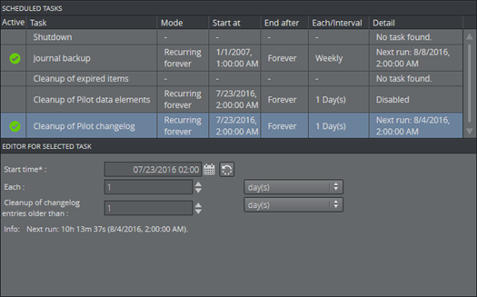

Scheduled Tasks
All Viz Pilot cleanup tasks can be configured and activated via Graphic Hub Terminal. Open the Graphic Hub Terminal, then select Options > Scheduled tasks. Scroll down the task list to find the Viz Pilot related tasks.
Tip: In addition to the tasks described here, it is highly recommended to periodically perform a normal shutdown when using Graphic Hub as Viz Pilot data back end. The recommended interval is once monthly.
To enable the tasks, click Options -> Advanced settings in the Terminal and go to the CLEANUP SETTINGS pane. Check the checkboxes to enable each task:

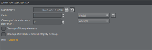

Cleanup of Viz Pilot Data Elements
Click on the task to open the configuration properties for the task:
The following properties can be specified:
  • Start time: Defines the first execution of the task.
  • Interval: Defines the interval on which the task is executed.
  • Older than: Cleans up all elements older than the specified time span.
  • Cleanup of library elements: Includes library elements during deletion when checked.
  • Integrity cleanup: Deletes all rows that violates Viz Pilot data integrity to provide data consistency when checked..
  • Cleanup of Pilot data elements: Can also be configured using the Graphic Hub Manager. However, it needs to be activated using the Graphic Hub Terminal. The Wizard appears after a successful schema import. Refer to Key Features and Workflow of GH3 as Viz Pilot Back-end System for further details.

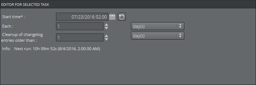

Cleanup of Viz Pilot Changelog

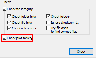

Graphic Hub Manager Integrity Cleanup
The Graphic Hub Manager provides a tool to perform an integrity check of Viz Pilot data and clean data integrity violations:
  1. Click Server > Check to open the Check Server window.
  2. In the Check section, check the Check Pilot tables checkbox:
    This includes a check for data consistency in the Viz Pilot tables during server check. If any violations are found, these are listed in the Pilot Data tab:
  3. If any violations are found, click the Fix all button in the Fix panel to delete those violations:
    The integrity cleanup can also be included during the execution of the data element deletion task (see Viz Pilot Tasks on how to include it) If it is included, all integrity violations are cleared during task execution.

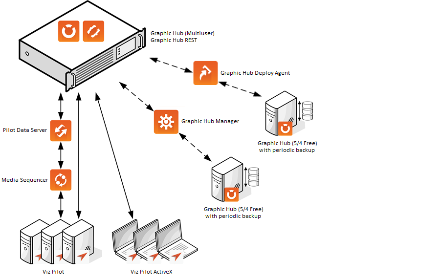

Viz Pilot Data Backup Solution
Using Graphic Hub Manager in Graphic Hub 3, Viz Pilot data can be backed up manually to a Graphic Hub server in 5/4 Free or Multiuser mode. Using Graphic Hub Manager and Graphic Hub Deploy Agent in Graphic Hub 3.2, Viz Pilot data can also be backed up automatically via Viz Pilot deploy tasks as outlined in the previous section. On the backup server, the Graphic Hub Terminal can then be used as a tool for creating full or incremental backups of the underlying data directory on Graphic Hub, using a scheduled shutdown task with backup after shutdown and server restart.
