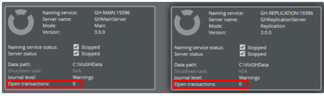

Check Open Transactions
From Graphic Hub version 3.0, the status of open transactions is shown in the GH Terminal main screen:
Warning: Do not proceed with an upgrade if there are any open transactions!
If required, the Graphic Hub Console can also be opened to check for open transactions. In the Graphic Hub Terminal, click Report > Graphic Hub Console.
For all previous Graphic Hub versions, use the following procedure:
  1. Open Graphic Hub Manager on both the machines (Main and Replication).
  2. From the main menu, select Tools > Monitor Servers.
  3. Check that Open Transactions are at zero.
