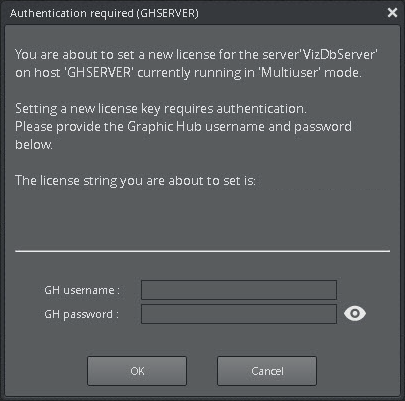

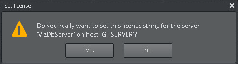

  5. Setting Authenticate with a Graphic Hub Administrator account, check the details again and confirm that you want to apply the new license.

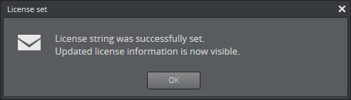

  6. If the license is successfully set, a dialog is displayed:
    If there is an error in setting the license, an appropriate message is displayed.

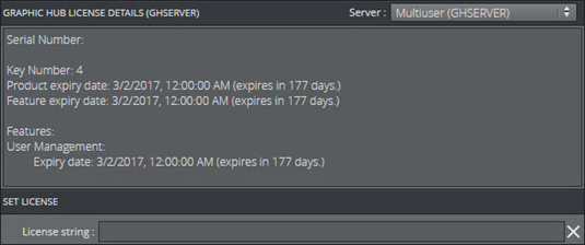

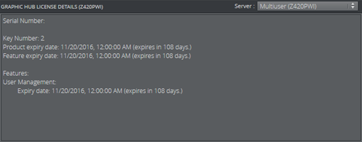

  7. The updated license information is displayed in the Graphic Hub License Details window.
  8. If the updated license information does not display immediately, try to refresh the license information by clicking the Refresh ref.png button.
