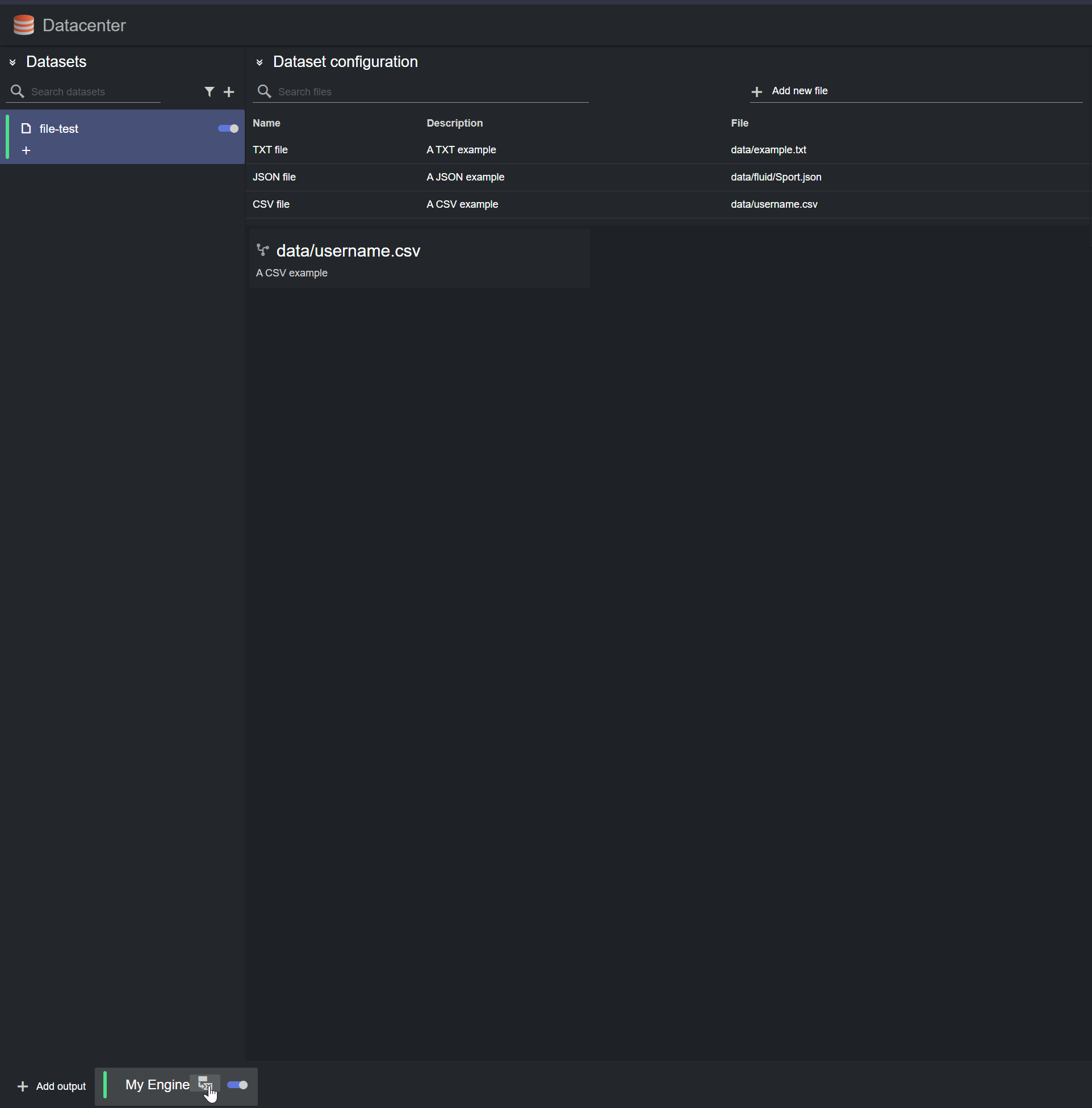

To do so, select a dataset from the Datasets panel and click on the custom mapping icon on the Viz Engine output to edit:

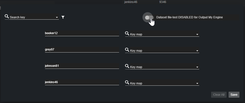

In the dialog that appears, switch the toggle in the right corner to Dataset <dataset name> DISABLED for Output <output name>, and press the Save button.
