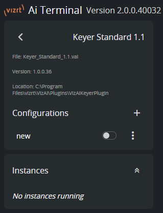

Create a Viz AI Runner Instance
After installation, Keyer Standard 1.0, Keyer Standard 1.1, and Keyer Studio 1.1 models are automatically discovered by the AI Terminal. Choose one, then:
  • Create a new configuration with the image-20260303-074449.png button.
  • Launch with an existing configuration using the power on/off image-20260303-074547.png switch.
Once the instance is powered on, a Viz AI Runner console becomes visible and its configuration can be opened under Instances.

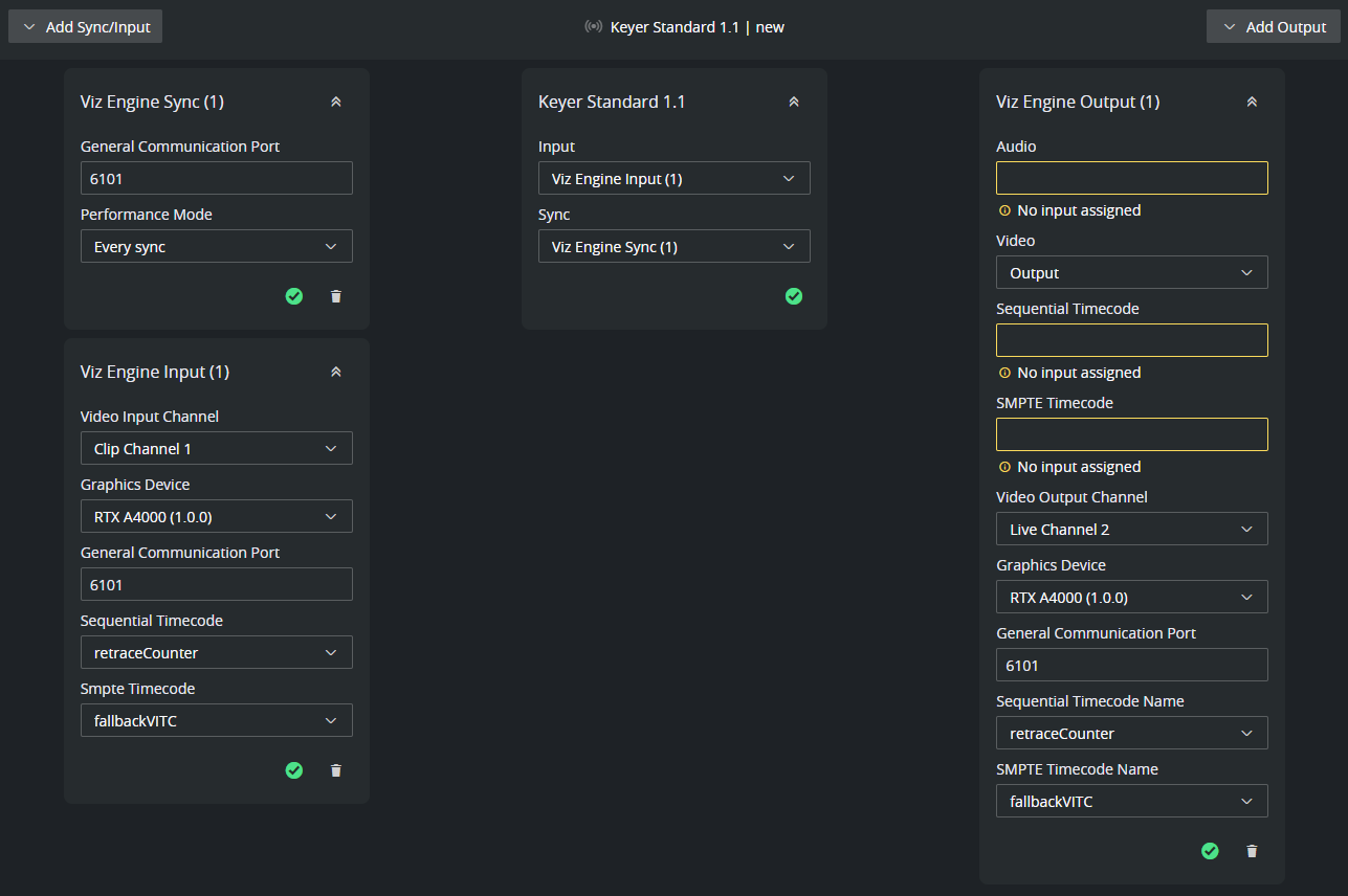

Input / Output Configuration
Viz Engine Sync Input
  • Specify the same value for General Communication Port as configured earlier in Viz Engine Configuration.
  • Set the Performance Mode to Every sync. If performance problems appear later when starting the tool, this mode can be changed to improve performance.
Viz Engine Input
  • Set the Video Input Channel to the configured live video source.
    • The dropdown menu is automatically populated and refreshed every 60 seconds.
    • In this guide, we assume that Live Channel 1 is the live video input source, as shown in the Viz Engine Configuration section.
  • Set Graphics device to the device the Viz Engine is running on.
  • Choose the Sequential Timecode and SMPTE Timecode to use (for example, retraceCounter and fallbackVITC, respectively).
Keyer Standard / Studio
  • Set the Input to the respective Viz Engine Input.
  • Set the Sync to Viz Engine Sync Input.
Viz Engine Output
  • Set the Video to Output.
  • Set the Video Output Channel to the configured SHM - SMURF source.
    • In this guide, we assume that Live Channel 2 is the SHM - SMURF source, as shown in the Viz Engine Configuration section.
  • Set Graphics Device to the device the Viz Engine is running on.
  • Choose the Sequential Timecode Name and SMPTE Timecode Name to use, as set in the Viz Engine Input panel (for example, retraceCounter and fallbackVITC, respectively)
Note: Entries for Audio, Sequential Timecode and SMPTE Timecode can be left blank.

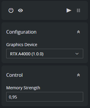

Tool Configuration
Configuration
  • Select the Graphics Device that is used by the AI Keyer tool.
Note: For the Keyer Studio 1.1 model it is highly recommended to run the AI Keyer on another graphics device than the Viz Engine is running on.
Control
Choose the desired Memory Strength value. This value affects how much information is retained into the model “memory” context and is applied immediately.
  • A value of 0.0 is equivalent to running the AI Keyer with no memory (“one-shot” prediction).
  • A value of 1.0 is equivalent to running the AI Keyer with the maximum memory context.
Information: Setting a value for the Memory Strength depends on the specific application. A memory strength of 0 helps removing ghosting artifacts that can otherwise appear in the case of fast moving objects or hard-cut scenarios. On the other hand, it can introduce flickering in the produced key, due to lack of temporal context. Similarly, a memory strength of 1.0 helps reducing flickering over temporal sequences, risking introducing ghosting artefacts in fast-moving scenarios. Start with a Memory Strength of 0.95 and only adjust it if needed.
Refer to Models for the individual model’s additional parameters.
Note: While not running, the Tool periodically contacts Viz Engine to retrieve information. While this operation happens sporadically, to avoid consuming resources make sure to close all Viz AI Runner consoles when not in use.

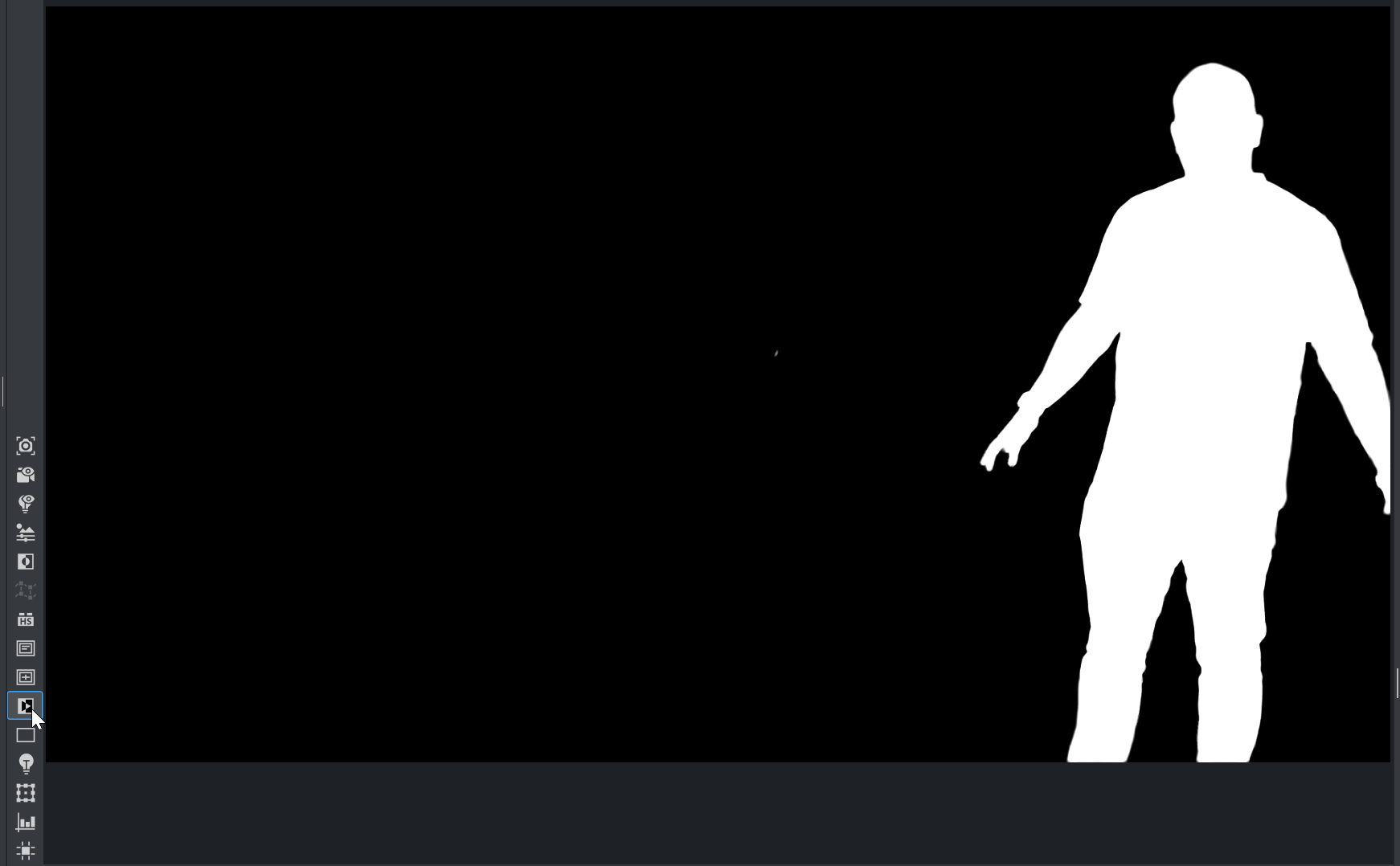

Verify Configuration
Start the tool using the play button image-20260218-161340.png in the top right corner of the page and verify that no errors are shown. Check the AI Terminal User Guide for proposed actions in case of errors.

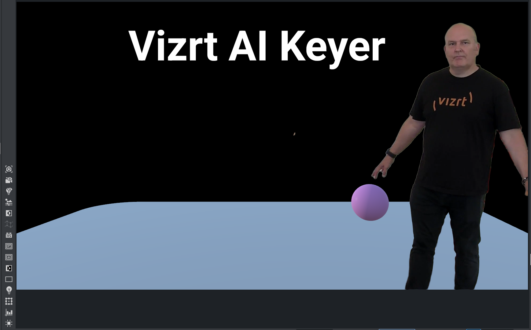

If all applications are setup as instructed, a scene designed as in Viz Engine Scene Design displays a correctly keyed talent.
This can be verified by clicking the Key ON/OFF button in the Engine Scene Editor window to preview the incoming key:
