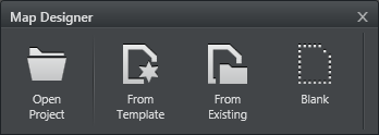

To Create a Map Template
Start the Map Designer.
Select one of the following options:
Open Project: Opens an existing project.
From Template: Starts a new project based on a selection of default stylesheets.
From Existing: Starts a new project based on an existing project.
Blank: Starts a new project.
