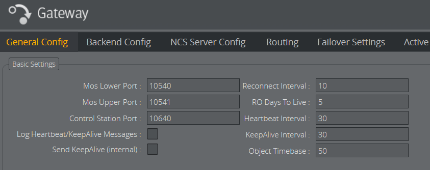

The General configuration tab contains Gateway’s basic settings.
Basic Settings
The following settings are global settings used by the Gateway.
  • MOS Lower Port: A listener port that the NCS connects to for sending media object related messages to the Gateway.
  • MOS Upper Port: A listener port that the NCS connects to for sending rundown related messages to the Gateway.
  • Control Station Port: A listener port that the control station Media Sequencer will connect to for communicating with the Gateway.
  • Log Heartbeat/KeepAlive Messages: Adds heartbeats as well as keepAlive messages to the Media Sequencer log file. The full MOS message will be logged when this setting is enabled.
  • Send KeepAlive (internal): Enables the Gateway to periodically (defined by KeepAlive interval) send internal keepAlive messages to the connected Media Sequencer. This helps maintain the connection and prevents firewalls from closing idle connections.
  • Reconnect interval (sec): Specifies the number of seconds that Gateway should wait, when the connection is lost, before trying to reconnect to the newsroom system(s).
  • RO days to live: Sets the number of days the routing between a running order ID and a control station IP should live. Gateway clears out all running orders that have not been updated for a given number of days. For details, see Active Running Orders section on active running order routing.
  • Heartbeat Interval: Sets the interval for how often heartbeat messages are sent to the NCS. 30 seconds is recommended.
  • KeepAlive interval: Sets the interval for how often keepAlive messages are sent to the NCS and the Media Sequencer. KeepAlive should not be sent more frequently than every 30 seconds.
  • Object Timebase: Sets the sampling rate of the object in samples per second. For PAL Video this would be 50. For NTSC it would be 60.

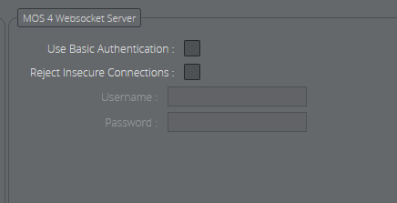

MOS 4 Websocket Server Settings
  • Use Basic Authentication: Whether incoming websocket connections from NCS servers or control clients need to authenticate with username and password.
  • Reject Insecure Connections: Whether to reject incoming unencrypted websocket connections and require clients to connect using secure websocket.
  • Username: The username for authenticating incoming connections when Use Basic Authentication is enabled.
  • Password: The password for authenticating incoming connections when Use Basic Authentication is enabled.

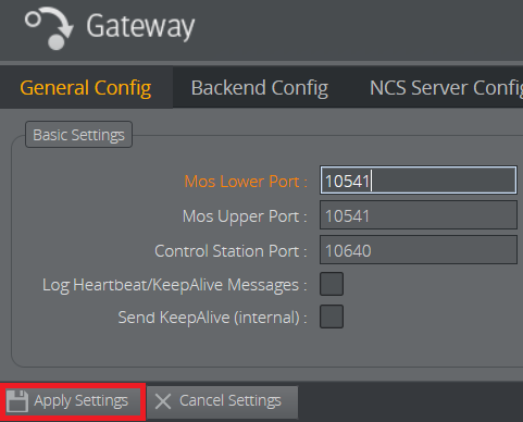

How to Enable Settings
Enable settings by:
  1. Edit a Basic Settings field.
  2. Click the Apply Settings button.
  3. Restart the Gateway.
  4. The settings take effect when the Gateway is started.
