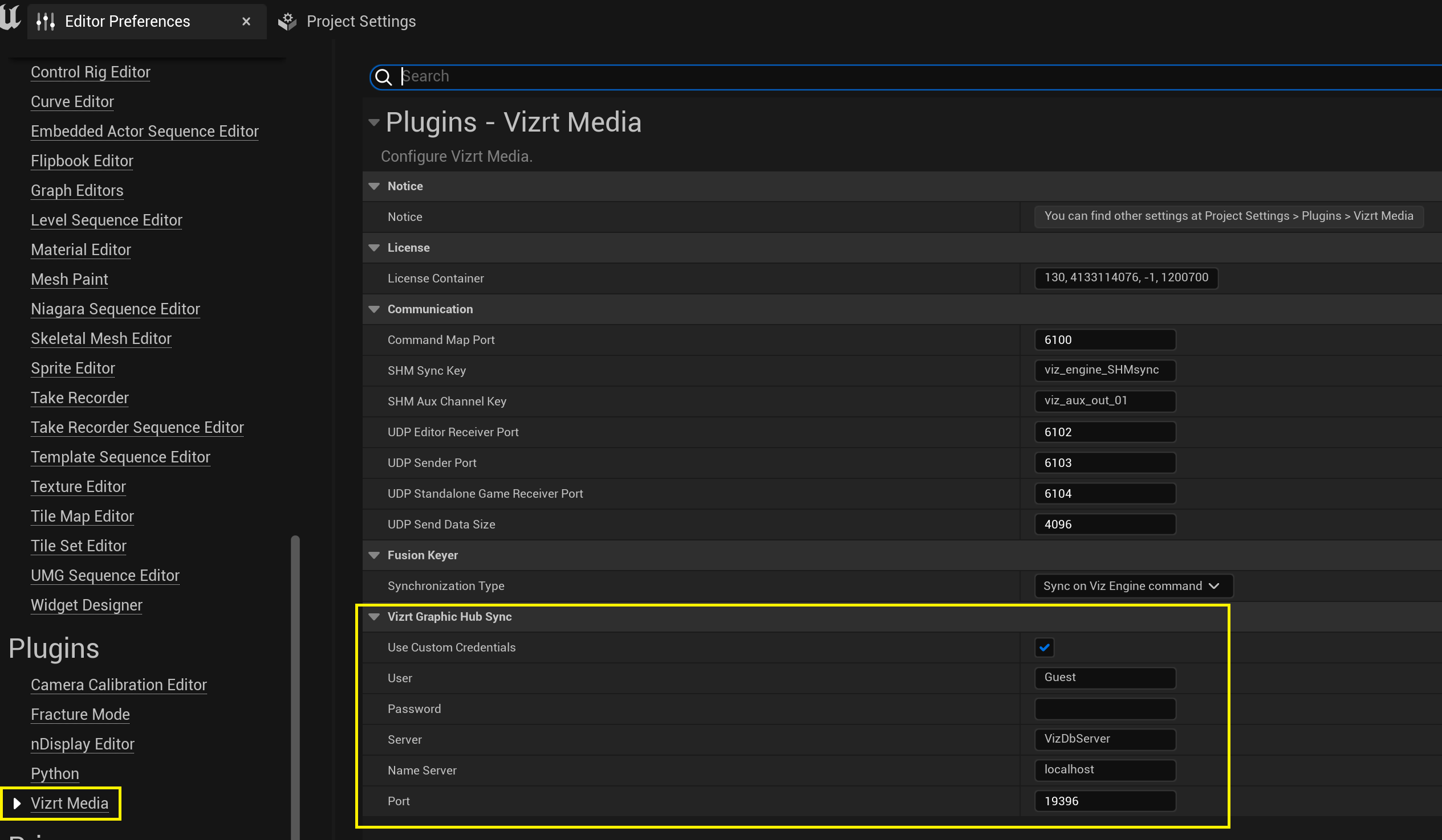

  1. Go to the menu Edit > Editor Preferences, navigate to the Vizrt Media section.
  2. Configure the credentials to login to the Graphic Hub server.

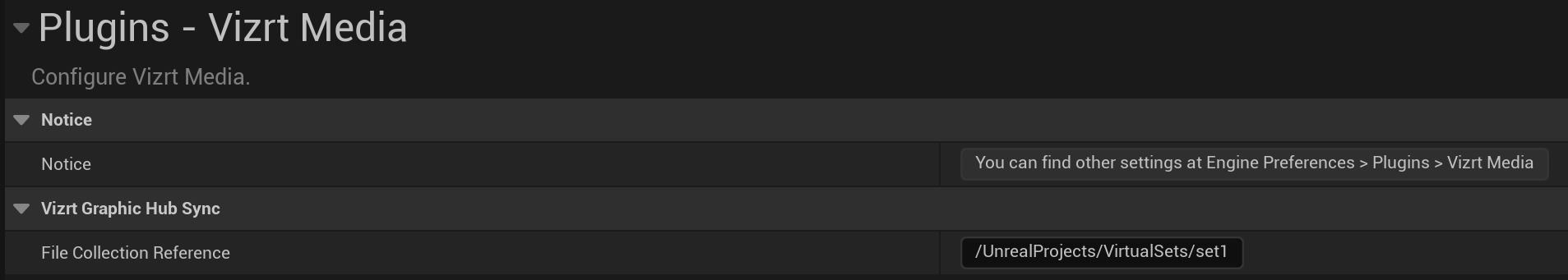

  3. Go to Settings > Project Settings. Navigate to the Plugins > Vizrt Media section.

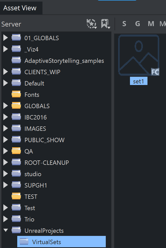

  4. Name your File Collection. In this example it was named /UnrealProjects/VirtualSet/set1.

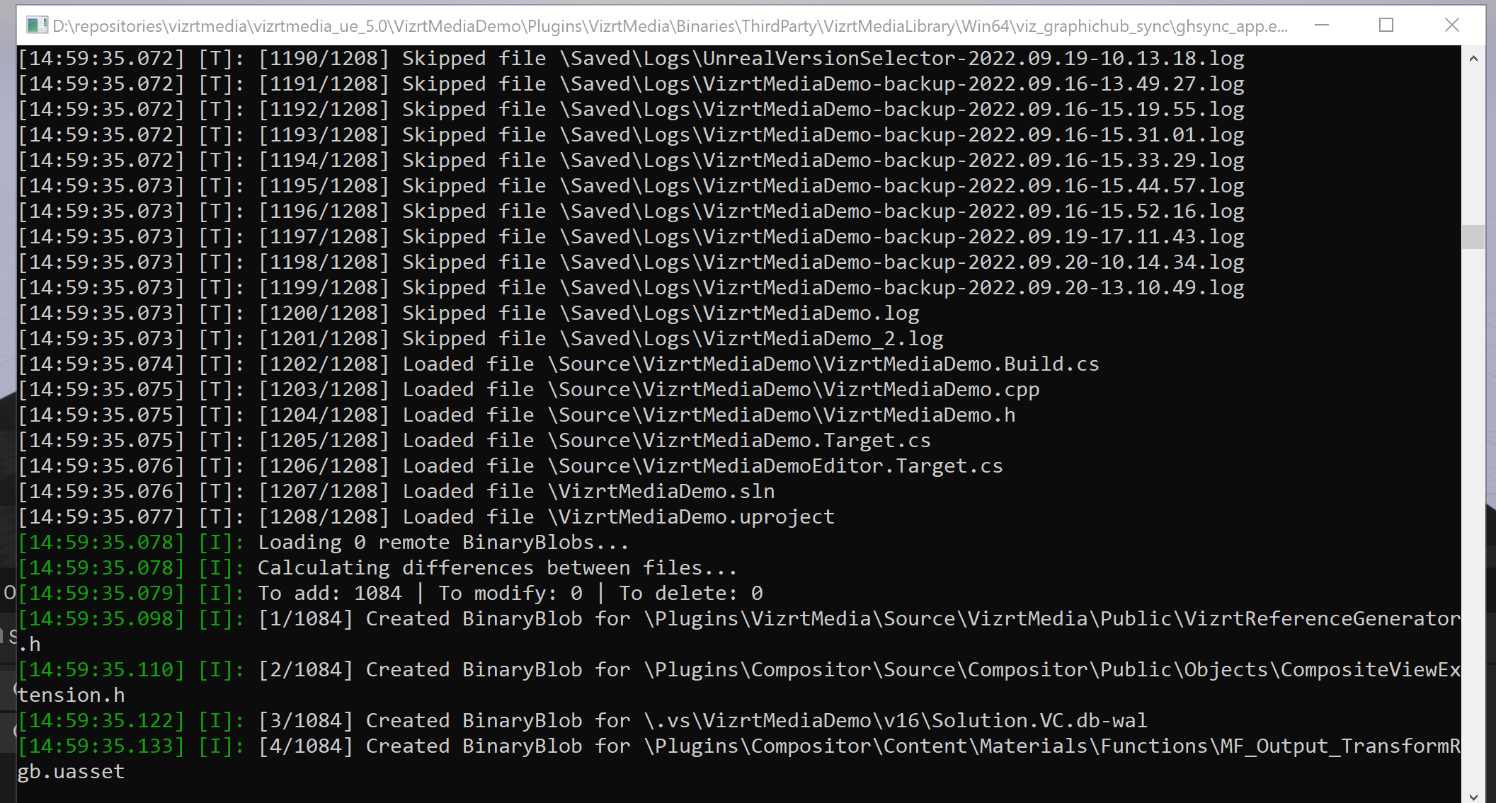

  5. Click the Store UE project in button in the toolbar.
  6. A window opens logging the state of the store action. When the window closes the action is completed.
    After the process is completed it's possible to confirm that the Unreal project was successfully synced with Graphic Hub using the GH manager or Viz Artist.

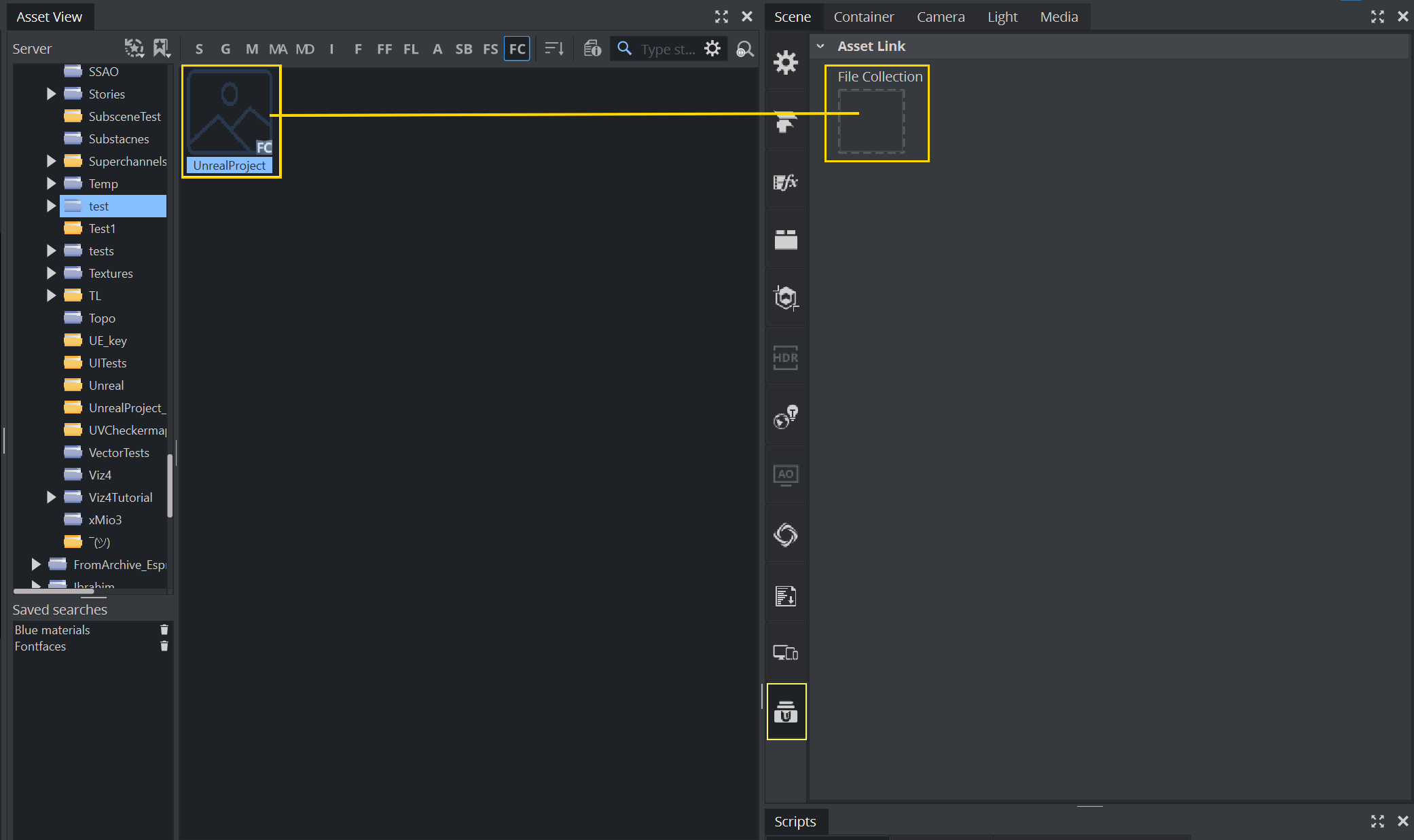

To Link a File Collection to a Scene
Drag a File Collection to the Scene Settings of any open scene.
To remove the file collection, double click on the blue File Collection label.

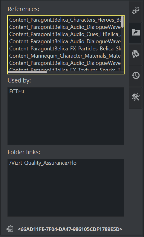

The Content of a File Collection
What is inside of a File Collection is hidden to the Viz Artist User to keep data consistent and protect the data from accidently being deleted by the user. However, to see which files are referenced by a File Collection, use either Graphic Hub Manager or use the Properties Panel of Asset view:
