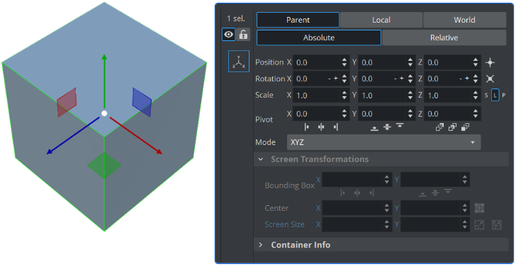

3D Transformation
Three dimensional space defines its objects by XYZ position, scaling and rotation. This space is well known by any 3D artist.
Three dimensional designs are used for virtual sets, AR graphics, simulations etc.
Objects in 3D space can intersect each other and there is no automatic layout. The positioning is absolute and can usually only be influenced by plug-ins or script logic. Measurements are done in units (one vizunit is comparable to one centimeter). Objects in 3D space can be modified in local or in world coordinates.

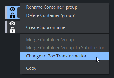

To Switch between Box- and 3D Transformation
The type of transformation is automatically switched if a Flexbox plug-in is assigned. You can quickly switch between the different types of transformation modes by right clicking and selecting Change to Box Transformation or Change to 3D Transformation.

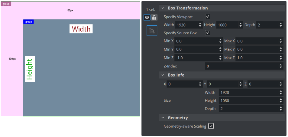

3D Objects Support for Box Transformation
Since Viz Artist version 5.1, Box Transformation can handle 3D objects using the new parameters added for depth and z coordinate control.
We added depth values and z values for Box Transformation and FlexBox plug-ins, in the FlexBox plug-in we have a flag to control if we want FlexBox to control Box Transformation's depth/z values or not, the flag also controls auto modes of Box Transformation.
Box Transformation
  1. min/max z for source-box: Specifies the min/max values for z in the source box.
  2. Depth for viewport: Specifies the depth value of the viewport.
  3. Z and Depth for box info: Specifies the z position and depth value of Box Transformation.
3D Content Section in FlexBox Plug-in
  1. Update BoxTransformation flag: This flag is enabled by default, if enabled, the flex box controls the z, depth, and auto mode for source-box and viewport of Box Transformation and x/y and width/height values of box info in Box Transformation. If it is disabled, FlexBox just controls the x/y and width/height values of box info in Box Transformation.
  2. Box Transformation Z: Control the z value of box info in Box Transformation.
  3. Box Transformation Depth: Control depth value box info in Box Transformation.
